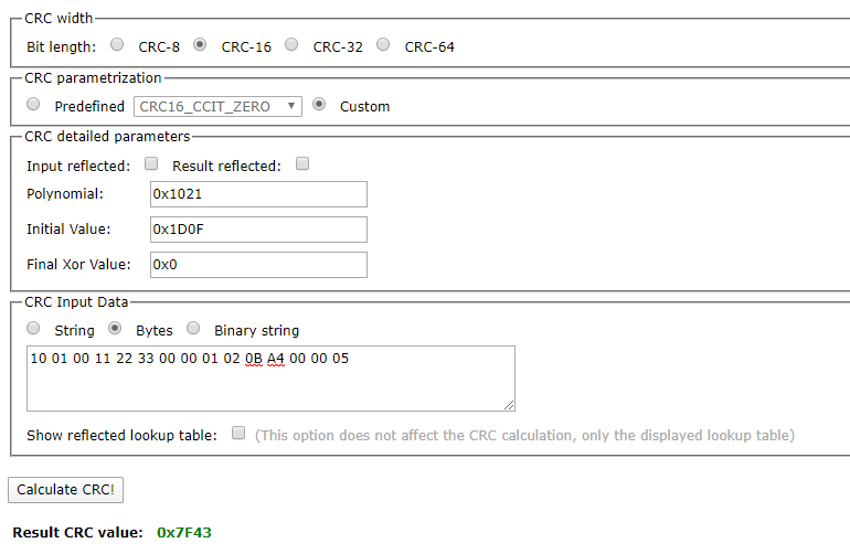

My online checker (the reference) : Sunshine's Homepage - Online CRC Calculator Javascript
Config :
If you have an idea of how to fix this, i will be grateful.

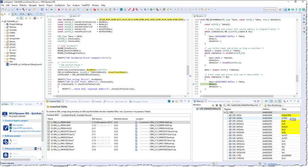

Robin_Shen
Please download the MCUXpresso SDK of KW36, then refer the CRC example.
You will get the 7F 43 after modify show below:
If you don't want to use APIs of MCUXpresso SDK, then you can configure CRC registers according to the image.

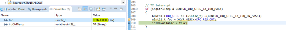

loic_guillaume_
Hello Robin,
Thanks for the reply,
The thing is,  when I check the calculated crc, it is the correct one (0x7F43) :
But the one sent is not (0x7FC3).
And I'm sure it comes from the "sender" and not my receiver because if I set the crc manually (crc software), i always get the correct one.
So I don't know how to explain that.
I would like to know, where the alteration happen.
Also, as I said, the problem dissapear if I disable the Ref input.

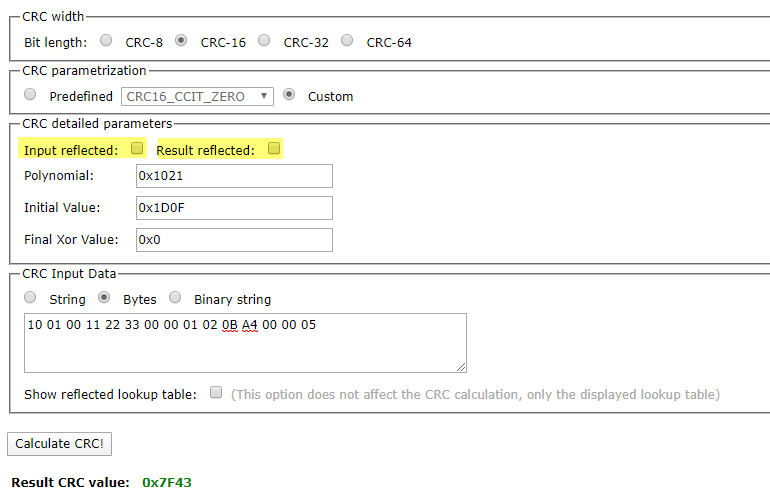

Robin_Shen
Sorry for my last reply! I didn't have KW36 on my hands. The CRC module seems different between K64 and KW36.
But I don't know why you configure Input reflected and Output reflected.
For your predefined crc (Init / Poly / XorOut) and online checker, it seems you don't need to reflect input and output.(I didn't reflect in my example too.)
Robin

loic_guillaume_
The thing is, to send 7F43 as the crc I need to reflect the input and the output on the sender side.
In my previous reply, both are enabled. If you don't, the Online Crc and the one sent is different.
Loïc
