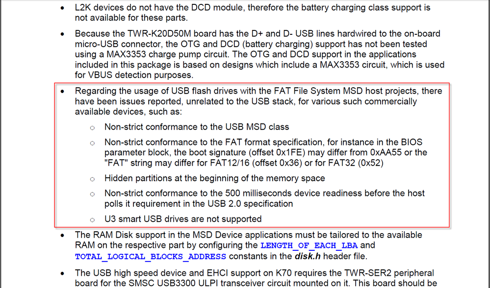

Hi Shabana,
I think that might be some incompatible issue between the usb stack and the pen driver, just like what is mentioned in the release note for usb stack ver 4.1.1.
Kan
