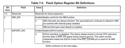

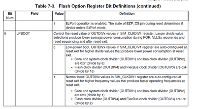

I had gone through FOPT register for modifying FSEC register in the application code in reference manual for Kinetis K66 MCU as per your link in previous reply. But there is a little information about FOPT register in reference manual. In the manual they are mentioning like go through "Chip configuration details" for information on bits in FOPT register. But I could not find Chip configuration details topic in reference manual anywhere.
Can you please send me link or details regarding Chip configuration details for me to work on.

Hope you are well. The details are provided in the table 7-3 of the reference manual in section 7.3.3. The register contains read-only bits that are loaded from the NVM's option byte in the flash configuration field. The user can reprogram the option byte in flash to change the FOPT values that are used for
subsequent resets.
Please let me know if you have further questions.

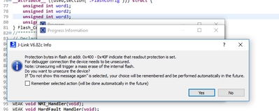

By following previous comments I hardcoded a customised hexadecimal value in 'startup_mk66f18.c' file in the flash configuration field in structure having values like {0xFFFFFFFF, 0xFFFFFFFF, 0xFFFFFFFF, 0xFFFFFFFE}. I changed it to values like by including 0x40(KEYEN = 01, MEEN = 00, FSLACC = 00, SEC = 00) in {0xFFFFFFFF, 0xFFFFFFFF, 0xFFFFFFFF, 0xFFFFFF40} by modifying last word for enabling security using FTFE_FSEC at 0x40C address. But when I flash the code with above values, the value written at 0x40C address is 0x42 instead of 0x40. If I modify the value as 0x44 as value at 0x40C address 0x46 is written instead of 0x44. I am unable to implement security using that written values at 0x40C address. The bits are forcibly writing as 10 in 'SEC' bits.
Can you please give some suggestion to write the desired value(0x40) at 0x40C address in flash configuration field?

As per your advice I replaced the value with 0xFC, 0xFD and 0xFF in the flash configuration field structure. After flashing when I see the flash using J-Mem tool from Jlink I am seeing the value 0xFE is written at 0x040C for all the 3 cases.
I am using JLink Ultra+ debugger from Segger to debug and see the flash memory.
Can you suggest some solution to secure the flash by writing to 0x40C address using a desired value(0x40)?
Also I am getting the below window in snip while flashing the image to MCU.

Sabina_Bruce
Hope you are well. In fact you are securing the device properly, if not you would not get the message in your screenshot. The reason this pop up occurs is to make sure that you would like to unsecure it in order to use the debugger. If you select no then the device will remain secure but you will not be able to use the debugger.
Since you are selecting yes, in order to read the outcome of these bytes you are seeing that the last byte is unsecured, because the debugger needs it like this in order to have access.
Essentially you are not doing anything incorrectly, but it depends if you want to continue to use the external debugger. Normally when you are ready to secure the part, it is because your application is ready and you will no longer need to debug your microcontroller.
