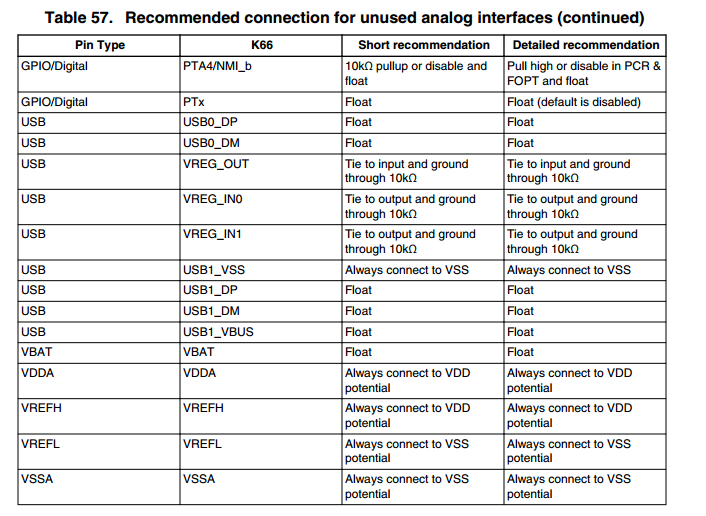

If I'm using a mk66 part how do I wire it for only using one usb port?

The data sheet only mentions not using both ports:
I'm thinking tie Vreg_IN0 to Vreg_IN1
I would use the USB1 port so I have bus detect. then float USB0_DP and USB0_DM
Vreg_out would have some caps for filtering but otherwise would not be used.

There is a Note at K66 chapter 53 USB Voltage Regulator:
When USB is not used in the application, it is recommended to connect VREGOUT and VREG_INx together and tie to ground
through a 10kΩ resistor. Do not tie directly to ground, as this causes a latch-up risk. For systems where only one of the VREG_INx pins is ever used, it is also recommended to connect the two VREG_INx pins together.

I had decided to just tie the two regulator inputs together. It is always good to get verification that design choices are correct!
