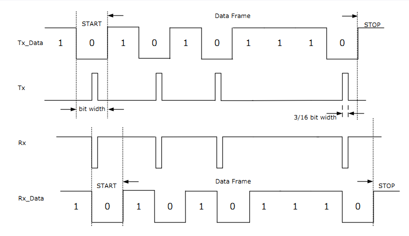

       The answer lies in the waveform attached. In the code from the above discussion, the PWM modulation is performed on FTM channel for transmission, while the communication that customer required was different and the waveform required is the one attached.

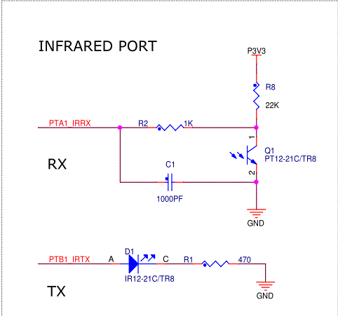

     Note that the IRDA transmitter on FRDM-KE02Z is connected to UART0. But, in the attached code, UART0 is not configured for IRDA_TX. while ACMP is used for RX.
     This post is intended to be a reference to those who want to implement IRDA with 3/16th bit width by bit banging.
     Here is the schematic snapshot of the FRDM-KE02.

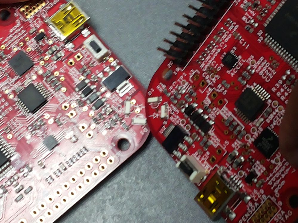

1. FRDM_KE02_singleboard_IRDA_BITBANGING_TX_RX - IRDA on a single board.
2. FRDM_KE02_interboard_IRDA_BITBANGING_TX_RX - IRDA between 2 boards.
  To run a single board demo, the orientation of IRDA Transmitter and IRDA receiver is already taken care as both are on the same board. But, to run the second demo, the orientation is supposed to be something like this.

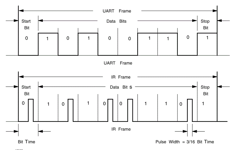

     The figure in page 13 of this document is referred while development. http://www.vishay.com/docs/82513/physical.pdf

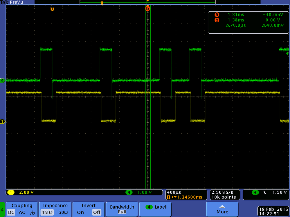

Transmission -
1. The bit width is calculated depending on the required IRDA baud and PIT1 modulo is adjusted accordingly. There are 3 MOD values initialized one after the other to generate required IR frame.
2. The data to be transmitted is sent over the HyperTerminal @ 9600baud. This data is accordingly transmitted on PTB1.
     The green waveform in the below oscilloscope snap is the IR frame from the above picture. The data being sent is 'e', the hex value of which is 0x65 which can be made out from the waveform. 0x65 is 0xa6 in reverse since LSB is sent out first in the IRDA protocol[The first logic high is the start bit. In IRDA transmission, logic low is data '1' and logic high is data '0'].

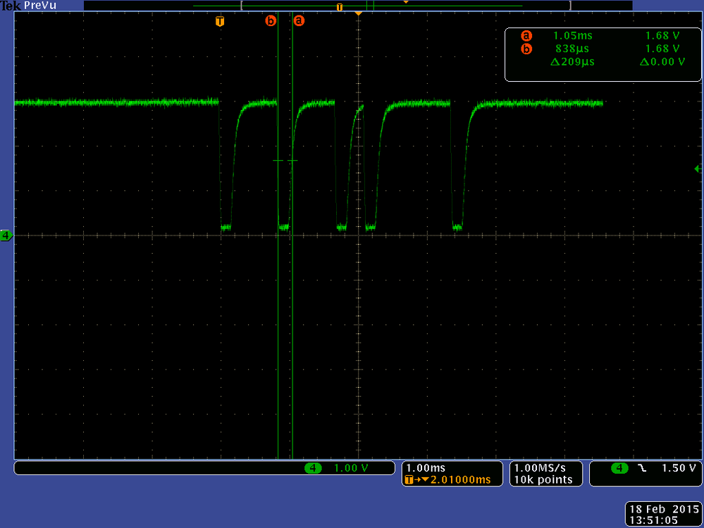

     The below waveform is the one probed at PTA1.
