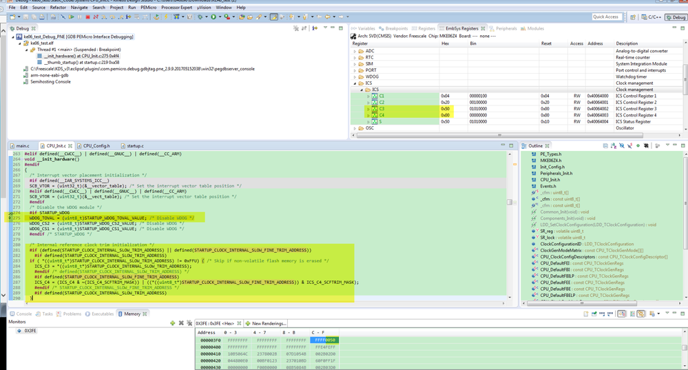

I've got a peculiar problem.  We are using a KE06Z128VLH4 and KDS 3.0.0.  The KE06 is using the FEI clock at 48 MHz and we are using a P&E Multilink Universal FX.  For some reason, during debug in one environment the ICS_C3 register which trims the internal clock is being reset to 0x80.  The default values are typically 0x4f-0x5b for the factory trim value.  What is strange is that using the same debug configuration settings and the same board, one computer is debugging normally with the ICS using the factory default trim, but on another the trim is being reset to 0x80, which is throwing the clock off.  We can't find any option under the debug settings to control this, and we are using the same ARP file.  We even tried deleting the debug configuration and creating a new one.  The board boots normally out of ROM and runs at the correct speed, it's just under debug on one machine the ICS is somehow being changed.  Is there some option that we are not finding?  I see the ARP file sets the ICS trim value, but is there someplace else the debugger changes it?  I've confirmed that the 0x3FE and 0x3FF locations contain 0x4F and 0x00 respectively for the board.

Thank you, but apparently enabling the ability to initialize the slow trim value does not cause STARTUP_CLOCK_INTERNAL_SLOW_TRIM_ADDRESS to be defined in the version I have, so it never reached the code in CPU_Init to read from 0x3fe and 0x3ff to set ICS_C3 and ICS_C4.  I saved the PE configuration, re-generated the processor expert code, but it did not work.  Where does the KE06 read the default values from at reset?  Apparently it is not 0x3fe and 0x3ff. I moved the line from CPU_Init to actually run and set the clock, but it set ICS_C3 and ICS_C4 to 0xFF.  My chip would power up with 0x58 and 0x0 for ICS_C3 and ICS_C4_SCFTRIM and run at the correct clock speed, but it had 0xFF stored in 0x3fe and 0x3ff.  I used the debugger option to re-calculate and store the values in those locations.  They are programmed there now, but I'm curious where the chip gets the factory default trim values from at reset.pastedImage_2.png

   The trim value have the specific algorithm, the P&e debugger tool will calculate it, then put it in the address 0X3FE and 0X3FF, then the code after startup will read these flash address, and put it in the ICS trim register. After reset, the trim value will use the factory trim data in default, if you trim it, the chip will use the new trim vault, otherwise, it will use the factory trimmed data.
  After the factory programmed location, it is not share with the customer, we also don't know it.
  So, if  you want to trim the chip, you can use the P&E debugger tool to realize it, or you can use the external crystal, then you don't need to use the trim function to get the other internal frequency which is different with the factory trimmed frequency.

Hello Kerry, if you go back and read my other posts, the chip had 0xFF stored in 0x3FE and 0x3FF, yet the ICS powered up with correct trim value running under debug.  Where does the ICS get this factory reset trim value from?  Hint:  It's not 0x3FE and 0x3FF.  Please answer the question.

Thank you for your assistance, I appreciate it.  We were only trying to find out how to read the factory trim value, and it seems we can't.  Our automated production programming does not perform the trim operation since the factory trim has always been fine.  For unknown reasons one debugger is corrupting the ICS on multiple boards and throwing the timing way off, but the same boards power up fine running from flash without code to set the ICS C3 and C4 bits.  We were hoping to avoid having to make a debug-only configuration to overcome this problem and/or modifying the production programmer code to perform the trim operation.  We will manage though, thank you.
