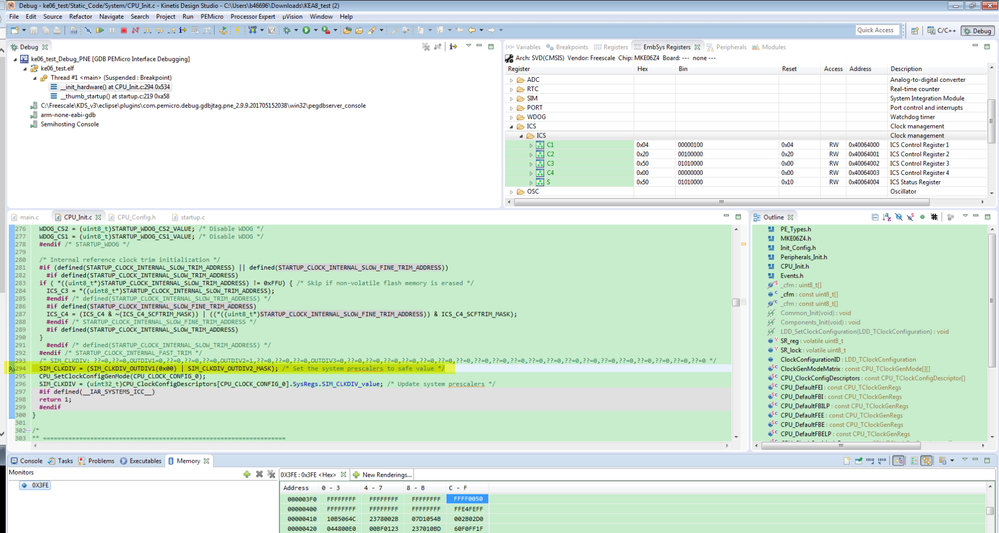

I've got a peculiar problem.  We are using a KE06Z128VLH4 and KDS 3.0.0.  The KE06 is using the FEI clock at 48 MHz and we are using a P&E Multilink Universal FX.  For some reason, during debug in one environment the ICS_C3 register which trims the internal clock is being reset to 0x80.  The default values are typically 0x4f-0x5b for the factory trim value.  What is strange is that using the same debug configuration settings and the same board, one computer is debugging normally with the ICS using the factory default trim, but on another the trim is being reset to 0x80, which is throwing the clock off.  We can't find any option under the debug settings to control this, and we are using the same ARP file.  We even tried deleting the debug configuration and creating a new one.  The board boots normally out of ROM and runs at the correct speed, it's just under debug on one machine the ICS is somehow being changed.  Is there some option that we are not finding?  I see the ARP file sets the ICS trim value, but is there someplace else the debugger changes it?  I've confirmed that the 0x3FE and 0x3FF locations contain 0x4F and 0x00 respectively for the board.

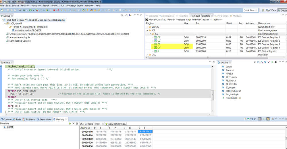

  This picture is the result which I enable both the trim function in PE configuration and the P&E debug configuration.
  You can find the 0X3FE and 0X3FF already have the trim data.
  The above picture, which I did copy the data from the 0X3FE, an 0x3ff, you can find actually, because the default factory trim value is 37.5Khz, so even I enable the re-trim function with P&E tool, the trimmed data is the same as the default factory data.
   This picture is after read the data from address 0x3fe, 0x3ff.
I also attach my test project for your reference.
3.  Didn't enable the trim function, read ICS_C3 and ICS_C4 with different PC.
  configuration:
PC 1 test result:
PC2 test result:
You can find, the same project, the same board, different PC, I can get the same factory trim result without the re-trim function.

Thank you, but apparently enabling the ability to initialize the slow trim value does not cause STARTUP_CLOCK_INTERNAL_SLOW_TRIM_ADDRESS to be defined in the version I have, so it never reached the code in CPU_Init to read from 0x3fe and 0x3ff to set ICS_C3 and ICS_C4.  I saved the PE configuration, re-generated the processor expert code, but it did not work.  Where does the KE06 read the default values from at reset?  Apparently it is not 0x3fe and 0x3ff. I moved the line from CPU_Init to actually run and set the clock, but it set ICS_C3 and ICS_C4 to 0xFF.  My chip would power up with 0x58 and 0x0 for ICS_C3 and ICS_C4_SCFTRIM and run at the correct clock speed, but it had 0xFF stored in 0x3fe and 0x3ff.  I used the debugger option to re-calculate and store the values in those locations.  They are programmed there now, but I'm curious where the chip gets the factory default trim values from at reset.pastedImage_2.png
  configuration:
PC 1 test result:
PC2 test result:
