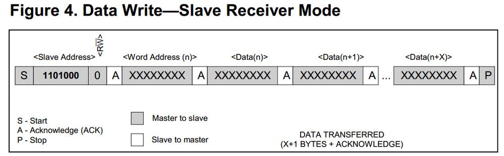

I read the i2c_masterreadwait() function.
It is transmitting 0x68<<1. It the proceeds to read directly , without writing the slave register address (in my case 0x00) and 0x68 |0x01.
Similar is the case for i2c_mastersendwait() function.
Is there a problem me using the library or should I insert some code.?

Hi Suraj,
It seems so weird, I don't think the root cause is from the library.
And according to the DS1307's datasheet, you can see that the slave address would be sent directly without plus send a 0x00.
And I'd highly recommend you to use the oscilloscope or logic analyzer to capture the wave, it can illustrate the root cause intuitively.

surajka
But is there a way to send slave address using the library? I am tried a lot of things but I haven't got an oscilloscope. I am currently using a library which creates problem if ds1307 is damaged/not inserted.
