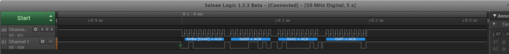

gianlucacaligna
Thank you for your answers,
As you can see in the picture ( Image_2 ) the register is correct, and in pictures Image_3 and Image_4 you can see the all steps I made to read a register which are the same that Hui_Ma suggested.
Have a nice day.

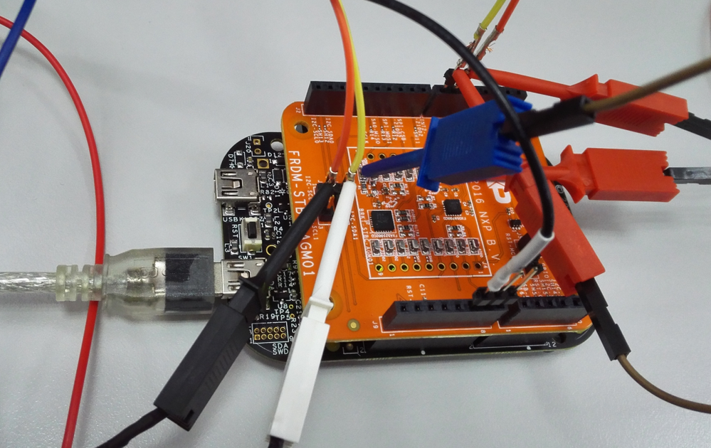

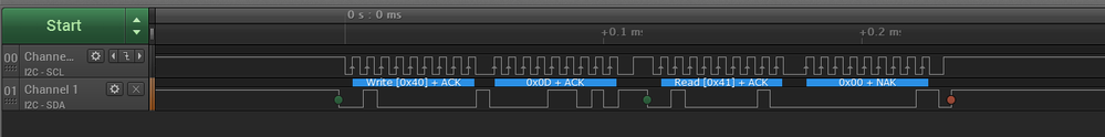

I did a test using FRDM-KL25Z board with FRDM-STBC-AGM01 board to read FXAS21002C CTRL_REG0 register value.
Below is my test environment:pastedImage_0.png
The I2C communication signal is below:
There with correct re-start signal.
I also attached my test code for your reference.
Wish it helps.
Ma Hui

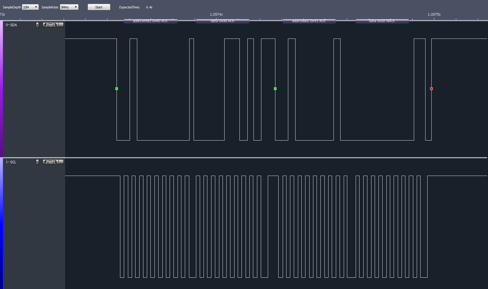

MarcoGiammarini
I work with Gianluca in this project. We did the same test with libohiboard where we change the I2C function like you but the result is the same!
Below our setup and the result of logic analyzer:
Our code is:

We don't know where is the problem...
Marco

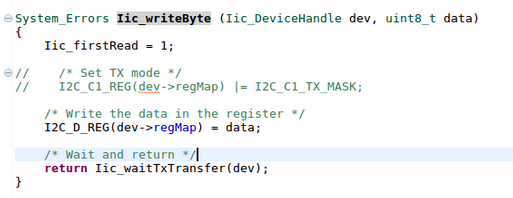

gianlucacaligna
Hi Hui_Ma,
Please note that in function Iic_writeByte there is already a wait function called Iic_waitRxTransfer(), but according to your suggestion I have changed the wait  and the result it was the same as the image below shows.
Thank you and have a great day.
