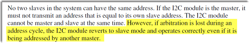

Hello Antonio Quevedo:
I do not have example code to test this situation, but your assumption is correct, when the Kinetis I2C module loses arbitration it automatically switches to slave mode and should respond to a matching incoming address. This text is from K64 Reference Manual:
Also, be aware that arbitration lost is not the only cause for the OnError event. You can find the error masks in PE_types.h:

Thanks! I am aware that there can be other reasons for an OnError call, and my software will deal with that. I just wonder if there is any way to make a test for bus arbitration loss. I am thinking on connecting the set input of a flip-flop to the SDA line (triggeting on trailing edge), with a push-button on reset line. Its output will be connected to an open-collector inverter, and its output to the SDa line. Thus, when my board lowers SDA, the flip-flop will lock this line on low, and my device will lose arbitration.
I will let you know if that worked.
