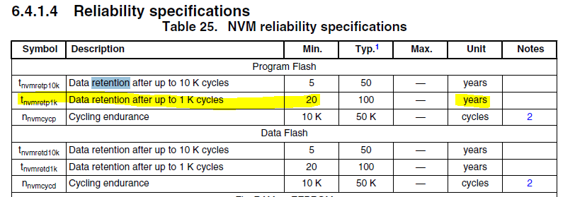

Thanks mjbcswitzerland​ and sergeisharonov​. The main reason I'm asking about ECC is I have an application that must endure an average temperature of 63C for a period of 25 years and I need to make sure that the MCU will retain the application for that long. The application never writes to the flash memory and runs entirely in SRAM so I think it will work under those conditions.

In that case I think that the specification that you are interested in is:
If just programming the code once tnvmretpk1 Min. gives 20 years, which I believe is over the temperature range up to 125°C (Tj).
You may need to contact your sales representative to get extrapolated values for your average temperature to ensure that it is >= 25 years miniumum.
