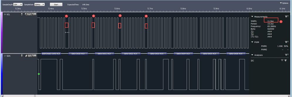

Dear NXP ,
   Now I am using KL43Z I2C as Slave Device , and I need to read data from KL43Z ( I2C Slave ) , and i found a delay ( about 16us between ACK & DATA ( Slave ) . as below CLOCK setting and LA Picture , Why this happen ? how to modify to solve this , i want to slave response quickly . The Situation as below ,
IDE : MCUXpresso
SDK Project : reference "frdmkl43z_i2c_interrupt_b2b_transfer_slave"
I2C Slave : FRDM-KL43Z
Setting : At 125KHz, SCK should be Hi 4us and low 4us
and there are some delay (about 2 clocks = 16us) before slave mode out to master.
Thanks a lot !!

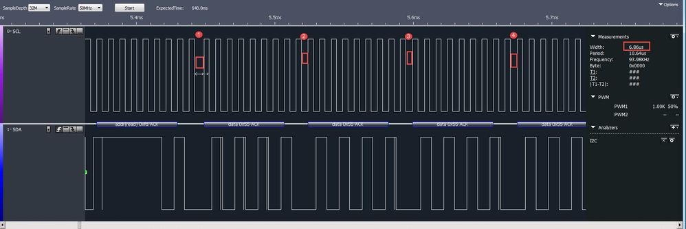

On my side, I modify the SDK interrupt handler, and change it to the register control mode, then the ACK&Data time is also decreased.
From my attached code, you can find if don't modify, the executed time is about 12us, but if I use the register control, the time is about 6.8us.
Actually, it is relate to the Handler execute time.

This picture is SDK code without modification:
This picture is using the register controlled interrupt handler:

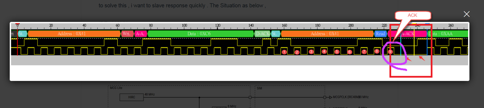

      From my own view point, I don't think it is the slave's problem. Because the slave already give the ACK to master, this delay should caused by the master, when the master receive the ACK, it is not send the data clock quickly.
    Just from your picture:
Bit 9 is the ACK point, you can find the slave already give ACK, it is low during 9th clock.
So, maybe you also need to check the master side.
Could you also tell me what the I2C master you are using? You can check that master code, when the master enter read mode, and get the ACK, the wait time between receive ACK and the next Clock sending. As you know, all the clock in the I2C bus is sent by the I2C master.
