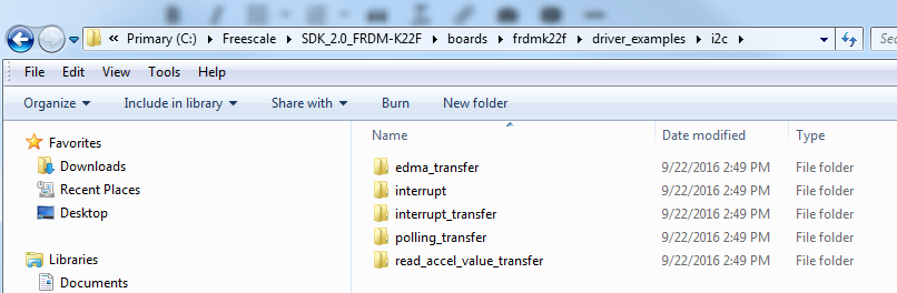

Blocking: Related functions perform a blocking transaction/receive, which means that the function does not return until all data is sent/received OR a time out occurs.
no Blocking: Related send/receive function returns immediately when set buffer pointer and length to transfer/receive buffer and transfer/receive Size. The user must check the status of I2C to know the whether transmission/receiving is finished or not.
Polling: Checking I2C status flag using polling way, not interrupt.
Callback: Using I2C interrupt way to do I2C transfer.
I would recommend customer to refer the latest KSDK V2.0 I2C driver examples with below examples:
Customer want to do I2C EEPROM operation could refer KSDK V2.0 provided examples.
Wish it helps.
Ma Hui

#1 For the KSDK V2.0 software architecture with big modification with KSDK V1.3 software, I would recommend customer to refer KSDK V2.0 software and related examples to redesign related project.
#2 Yes, the KSDK V2.0 doesn't provide the whole Kinetis product software package, which only provide single processor or single board related software package downloaded. Sorry for that may bring any inconvenience to you.
