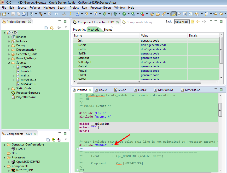

 I am trying to make the on board inertial sensor and I2C to communicate and blink LEDS based on xyz directions as RGB on a FRDM-KE02Z40M board. I didnot have a driver for the on board inertial sensor MMA8451Q on the IDE KDSV3.0 and PE and so I used the driver code for the sensor from the source link below.
https://mcuoneclipse.com/2012/09/21/tutorial-accelerating-the-kl25z-freedom-board/
The errors that I am getting is with regard to the definition of the struct on the device driver. (screenshot attached)
I am not sure why the object MMA8451_TDatastate is not being created or errors are thrown. Syntactically this looks okay to me. Any thoughts or suggestions are welcome. Thanks!

Hi SaiPriya,
The full project and source code is available from this link.
Have you include the "MMA8451.h" in Event.c?
