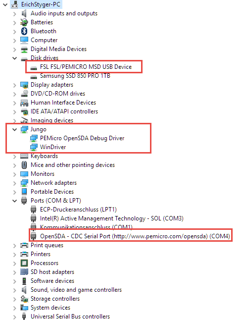

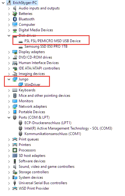

BlackNight
Hi Justin,
maybe I have missed it, but what host operating system are you using?
You only need to update the FRDM-KL25Z board bootloader if you are using Windows 10 or 8, but you need a Windows 7 machine for the update of the bootloader!
So can you confirm you are using a Windows 7 machine?
Here a few things where we could identify the problem:
1) Power/Plug in the board with the reset button pressed. It shall show up as BOOTLADER, with the following device in the device manager:
2) If you power the board with the P&E firmware loaded, it shall show up as FRDM-KL25Z, with the following devices:
For the copy operation outlined in https://mcuoneclipse.com/2014/11/01/illustrated-step-by-step-instructions-updating-the-freescale-fre..., do not use the file from the zip file directly. Unpack the files first. Use the DOS cmd.exe copy command and not the Windows Explorer. Disable any explorer extensions, firewalls or virus scanners.
In the debug connection, you have to use OpenSDA as interface:
I hope this helps,
Erich

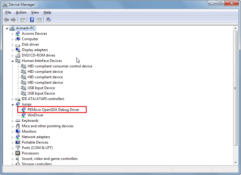

danielchen
Hi Justin:
The factory boards come shipped with an outdated firmware and application, To make the board working with Windows 8 it requires a bootloader update. To really use the board, the latest firmware needs to be loaded on the board too. could you try to update the firmware to see whether it helps?
Here is the step by step guide by my colleague.
14,258 Views
justinreina
Hey Dan,
I reinstalled the drivers following your instructions, validated the drive in File Explorer and the two items in Device Manager.
Present Items after driver reinstall
  • (File Explorer) FTDM-KL25Z(I:)
  • (Disk Drives) FSL FSL/PEMICRO MSD USB Device
  • (Ports) OpenSDA - CDC Serial Port (http://) (COM23)
Still no ports showing up for my debug launch, same as last time. Yikes, thoughts?
To note your LED is on in your picture, mine stays off. Also to note, I have purchased a new FRDM-KL25Z board, should be in within a few days.
Sheesh / thank you!! :smileyhappy:
14,258 Views

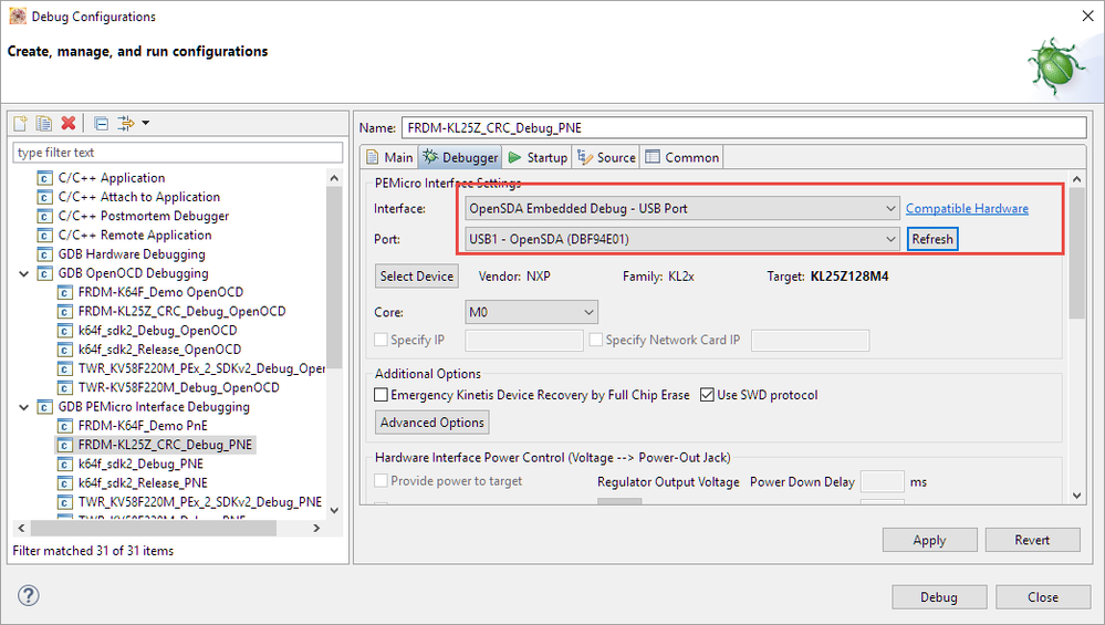

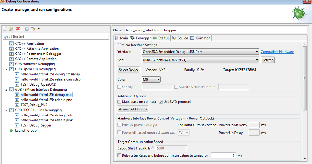

danielchen
HI Justin:
I suggest you make clean your project, then click ""debug"
and make it again. Then you can see the port info.
Please try it.
14,258 Views
justinreina
Hi Dan,
I gave this a shot just now, and same response, none listed :smileysad:
-Justin
