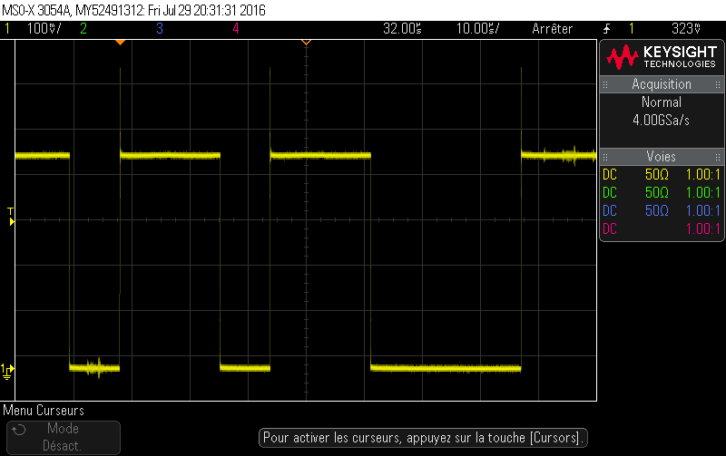

Hi everyone,
I got a noob question about the FRDM k64f  board :
I'm trying to set a RS232 communication with another device using UART2, the chars are well sent but the logical levels are weird : on my scope the high level of my data is about 500mV. Shouldn't it be 3.3V ?
Martin

    I think you also need to check your scope and probe configuration, you can test the on board fixed 3.3.V, is that correct on your scope?

Yeah my scope and probe configuration are correct and the 3.3V is ok on my board(s).
Sending 'ESC' char  at 115200 bauds :
I am going to test Mark Butcher's firmware right now to see what happens.
Thanks for your replies.
Martin

Are you sure you haven't connected the RS232 transceiver incorrectly (driving the UART2_TX line)?
If you want to check with a firmware which correctly drives the UART2_TX output, load the binary "USB-CDC with 5 UARTs" at http://www.utasker.com/kinetis/FRDM-K64F.html
You can then perform VCOM to UART bridges to all of the K64's UARTs to test yours (UART2_TX on PTD3) and any other UARTs that you may need.
