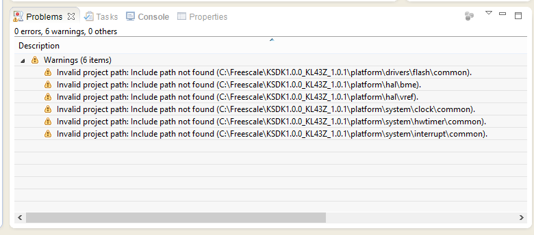

First I import the driver library, and I can build it with no errors.
If I import a demo from the demos folder I can build them, just six warnings (because search for 6 files that not exist?)

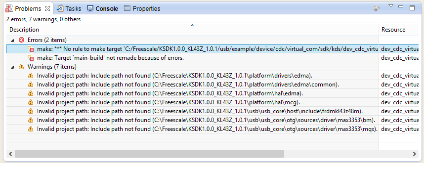

The problem is that if I import a project from C:\Freescale\KSDK1.0.0_KL43Z_1.0.1\usb\example\device, I get this

Hi Miguel,
About the USB demo , after the above operations, it need build the "usbh_sdk_frdmk43z48m_bm" lib .
it is here (...\KSDK_1.0.0-KL43Z\usb\usb_core\device\build\kds ).
Hope it helps
Alice
3,665 Views
gihu
Hello Alice,
Yeah!! That was it.

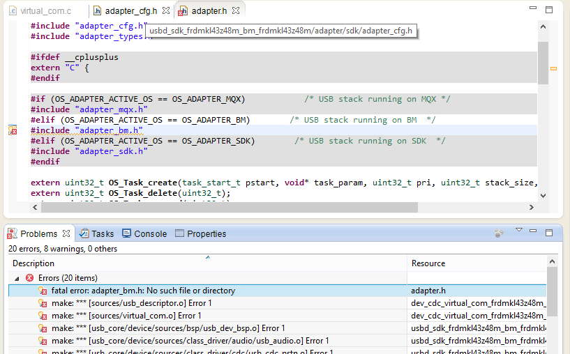

It is supposed to be a bare metal project, but adapter_cfg.h file looks like this:

So, OS_ADPTER_SDK is selected, and if I change to
#define OS_ADAPTER_ACTIVE_OS                 OS_ADAPTER_SDK
it stops working, because compiler does not find adapter_bm.h
I do not guess why I get working OS_adapter_sdk when all the open projects are bare metal :smileyconfused:
Any sugestion?

Hi Miguel,
Yes, I think is that : now on the KSDK_1.0.0-KL43Z, we only can use "OS_ADAPTER_SDK" .
the "OS_ADAPTER_MQX" and "OS_ADAPTER_BM" can not use now.
Because  we can not checked out "adapter_bm.h" and "adapter_mqx.h" file under the USB file .
