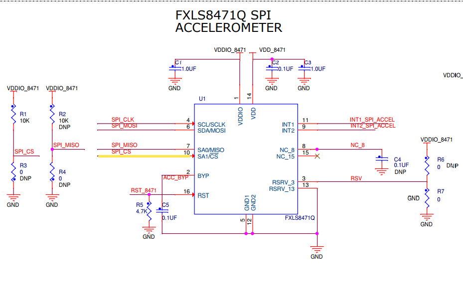

I am trying to interface FRDM-STBC-AGM01 kit with my controller XC2287 using SPI interfacing.
Is there any SLAVE address provided for FXLS8471Q, for SPI interfacing?
2,275 Views
Hui_Ma
I2C master need to know I2C slave address to get the data from I2C slave.
SPI master doesn't need the address, which using chip select to get data from SPI slave.

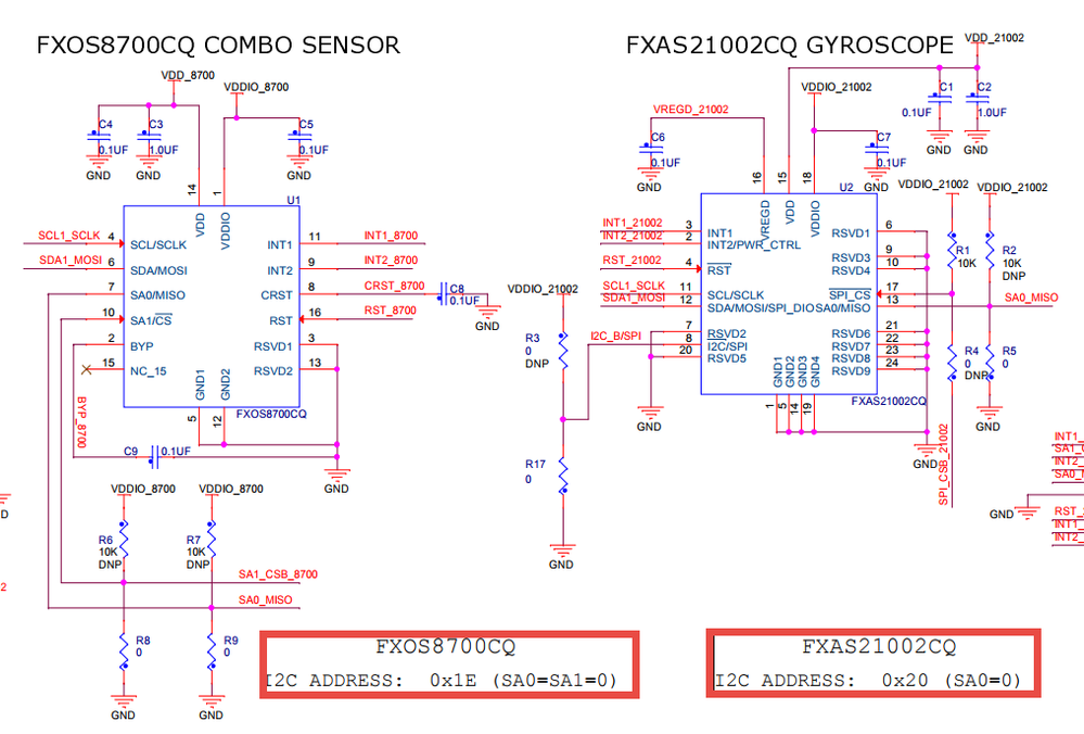

rajendramemane
FRDM-STBC-AGM01 sensor have 2 sensors (Accell+Magn,Gyro). Then how do we confirm that whether selected SLAVE is "Accell+Magn." or "Gyro".
2,275 Views
Hui_Ma
Please refer below FRDM-STBC-AGM01 RevC schematics:
The two sensor as I2C slave with different I2C slave address (check the red block for the I2C slave address).
Wish it helps.
