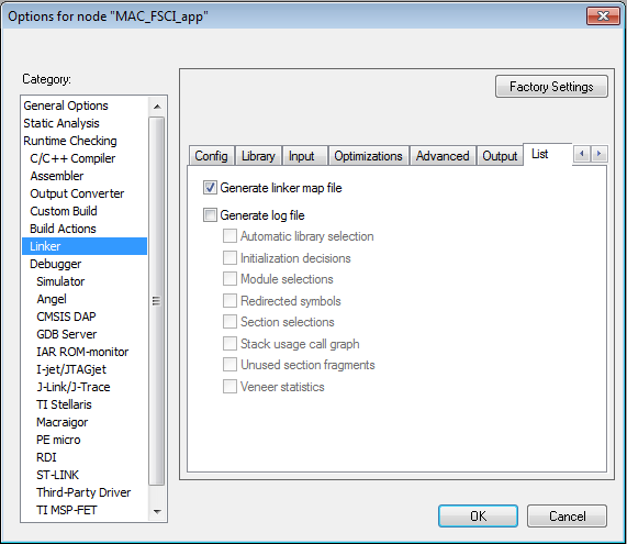

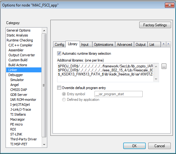

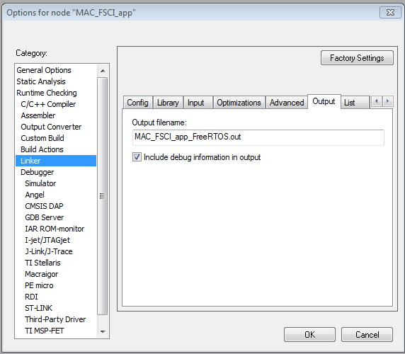

Error[Li005]: no definition for "main" [referenced from cmain.o(rt6M_tl.a)] ;
Hardware: FRDM-KW019032-ND
Trying to build the IEEE 802.15.4 demo software and seeing this error. This happened when I was building the library as the step 1. I have tried to change my linker setting but no use. Any suggestion?

I tried to replicate your issue but it works fine on my side, I tried with different examples but none of them gave that failure.
Could you please try to clean project and built again? As an extra note, please compile first the libraries and then the project.
 I’m also attaching some pictures of the linker settings I’m seeing on my side, hope it helps you on your settings.
