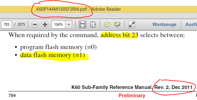

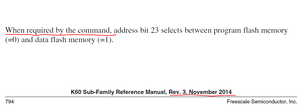

mjbcswitzerland
Specialist V
I believe that the details have always been there:
Mark
Kinetis: µTasker Kinetis support
K60: µTasker Kinetis TWR-K60N512 support  / µTasker Kinetis TWR-K60D100M support  / µTasker Kinetis TWR-K60F120M support
For the complete "out-of-the-box" Kinetis experience and faster time to market
3,825 Views
dmitriyc
Haha. Got me. Maybe if I had read that chapter three more times I would have noticed that.
Thanks for pointing that out. You don't have to call a "wambulance" to come pick me up. Yes technically it's there... technically. *sigh*
