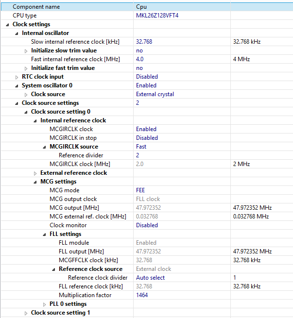

Hi, I'm using the KL26Z with an external 32Khz crystal for time keeping, which can generate
I'm trying to set up the USB to be a device - kboot - following some of the examples, and the first setup is the clock.
Working through KDS300 PE configuration for the  MKL26Z128VFT4, its wanting a 48Mhz clock.
I'm not clear on the basics of the MCG modes as to what I'm looking for - what multipliers I can try for, and whether the L26Z is designed to do this from 32Khz xtal.
I have run through setting up a USB MSC device for the FRDM-K20 following the excellent examples from McuOnEclipse, and it worked for setting up for a 24Mhz clock.
So can I set up the L26Z for the USB MSC device clock of 48Mhz or 24MHz ?

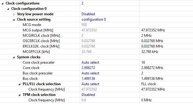

Here is what i've tried
I create a Clock Config 1 with Clock Source Setting 1- for normal mode
I use Clock Config 0 with Clock Source Setting 0 for USB mode
I set the MCG Mode to FBI to be able to the use the Fast Internal Clock (4Mhz/2Mhz), This then allows be to generate a 47.972353Mhz clock - (close to 48Mhz)
The CPU component is error free, however I can't get the USB Component to accept the 47.97352Mhz for its 48Mhz clock
Any help appreciated
thanks
Update: Actually I was close. For the USB_LDD component, I needed to input a 48Mhz clock frequency with an error that allowed the 47.972Mhz clock to be selected. ( I was double clicking the available frequency and then inputting the error - which it didn't like)  So I wonder if anybody has some comments as to if this should work?

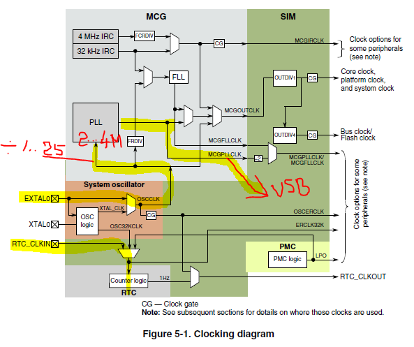

As has already been concluded (for the KL26), it is not possible to use the FLL as USB source due to its high jitter. 32kHz can also NOT be used by the PLL since the PLL requires an input reference between 2MHz and 4MHz.
This means that you can only use a higher frequency crystal or osillator (8 MHz is typical).
This is the MCG diagram for the KL26 with the only option that you have for the chosen chip if you want to also have high accuracy RTC operation and USB:
Note that the user manual forgets to show the PLL input divided (1..25) so EXTAL 2M, 4MHz, 6MHz, 8MHz etc. are in fact all suitable (for 48MHz core and USB).
You will need an external 32KkHz osciallator on RTC_CLKIN.
This is a standard setup for the KL26 in projects like you are planning.
If you prefer to save the 32kHz oscillator and don't require highly accurate RTC operation and wake up for low leakage modes you can still use the LPO to clock it. Or you can just not use the RTC since it can easily be accurately performed in SW from the main clock, including retaining the time/data across SW resets (the uTasker project has this option to completely emulate a more capable RTC like this without any HW RTC requirements).
I don't think you need to be worried about the KL27 in comparison to the KL26 for USB. The USB controller is identical apart from the new 48MHz IRC. I have used it in many newer processor without any issues and Freescale has proven USB certification on K22 and K64s, which have the (exact) same design as the K27.
