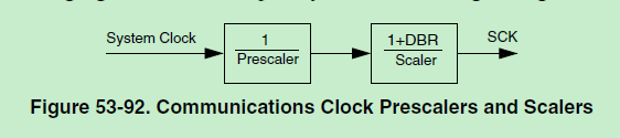

Hui_Ma
Hi Pallenna,
Please check K60 120MHz product reference manual chapter 53.4.3 about DSPI baud rate and clock generation.
The DSPI module clock source is bus clock.
About SPI communication with external SPI device example, I would recommend customer to check Kinetis 100MHz DSPI example, which K60 communication with external SPI Flash.
The code could be downloaded from here (KINETIS512_V2_SC).
Wish it helps.
