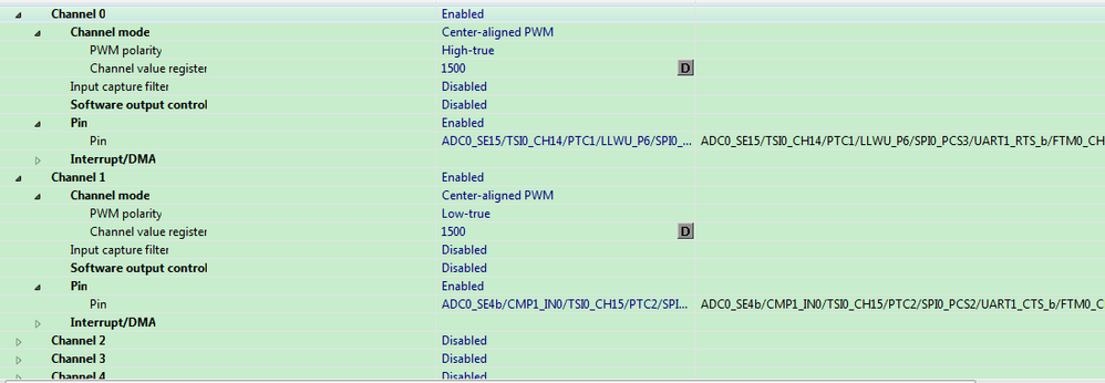

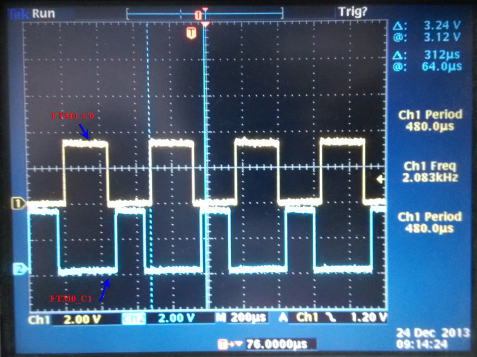

kerryzhou
Hi Kenta,
    I create a project base on TWR-K60D100M, and use the PE,  choose init_FTM component .
    Now in my project, I configure 2 channels, and test OK, you can refer to it, and create the other 4channels.
   My configuration is as follows,  please find my project from the attachments.
The test result is :
Wish it helps you!
If you still have question, please contact me!
Thank you and best regards!
Jing

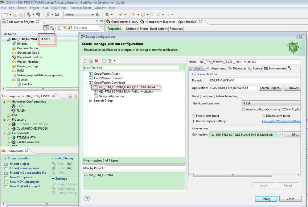

kerryzhou
Hi Kenta,
   Please configure like this picture:
make sure in Flash, not in RAM.
Then download the code.
Wish it helps you!
Best regards!
Jingjing
11,149 Views
changkenta
hi Jingjing,
follow the Flash configure, ... the code is Running after power On.
thank you so much.
Kenta
11,162 Views
