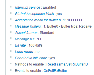

I'm trying to read an id of a bus CAN, I want to do that using RX interrupt, I'm using KEA128 and processor expert (CAN_LDD component).
Now I'm able to write to the bus CAN without interrupt, but when I try to read a message with a defined id nothing happens.
What I'm doing to read is the following:
FrameR.MessageID = 0x7DFU;                                       /* Set Tx ID value - standard */
  FrameR.FrameType = LDD_CAN_DATA_FRAME;                           /* Specyfying type of Tx frame - Data frame */
  FrameR.Length = sizeof(OutData2);
  FrameR.Data = OutData2; /* Set number of bytes in data frame - 4B */
  CAN1_ReadFrame(MyCANPtr,0,&FrameR);                   /* Sends the data frame over buffer 1 */
Does anyone know what i'm doing wrong and also what do I need to do to read using the Rx Can interrupt?

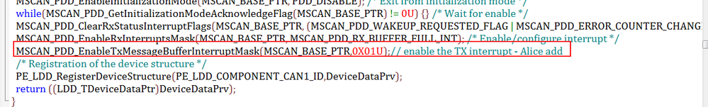

Hello Emilio,
There is a bug in the generated code in CAN1.c file ,it have not enable the interrupt.
Please add " MSCAN_PDD_EnableTxMessageBufferInterruptMask(MSCAN_BASE_PTR,0X01U);"
in the function of  LDD_TDeviceData* CAN1_Init(LDD_TUserData *UserDataPtr)
Hope it helps

Hello Alice,
I'm writting to the CAN bus every 100 ms using a timer interrupt without the TxInterrupt line you say, if i write de line the program doesn't work.
Do you know why??
And without the line is also working well the CAN1_OnFreeTxBuffer event in Events.c.

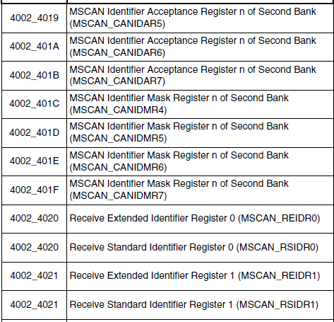

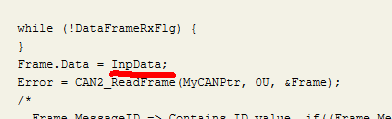

Hello Emilio,
About the read data , you can refer to the demo code :
- About the receive ID, you can configure here to control mask which one :
you can combined with the related registers to understand:
MSCAN_CANIDAR
MSCAN_CANIDMR
MSCAN_RSIDR
About use which variable to receive data , as for the below, it will use the "Inpdata[]",
so it mainly rely on the Frame.Data .
Hope it helps
Alice

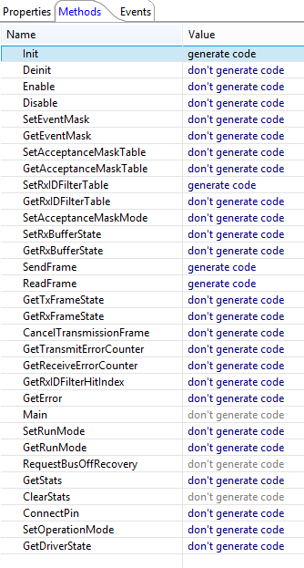

Hello Alice,
I refered to the demo code and the code needs the method.
But I didn`t find the method in the CAN_LDD component
What do I need to do to generate the method?
Another question, what do I need to write to the MSCAN_CANIDAR, MSCAN_CANIDMR, MSCAN_RSIDR if I want to read the ID0x7E8?
The reference manual there are a los of registers with those names
Emilio Moyers

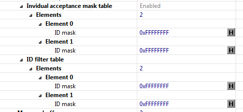

Hello Emililo,
- This demo is for CAN  on KIneites K series , sorry for my mistake.
The method of SetRxBufferID is also for K series, so you can not find it.
About the CAN demo for kea-128 , please refer to this thread, there also have a demo and the introduce:
I wonder how to get CAN to work with KDS's Processor Expert?
-About receive ID , at default  it can receive all of the ID if you do not configure these register.
For the MSCAN module of KEA series , the ID related registers' function is mask which ID ,
so if you do not need mask Receive ID, you can do not care it .
Hope it helps
Alice

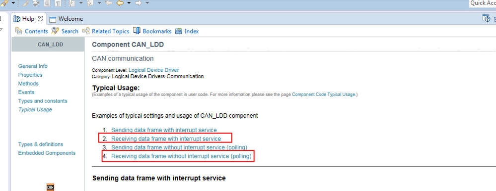

I can read one Id using the program in the help part of the CAN_LDD component. If I write this code in the program  main.c:
while(1){
  while (!DataFrameRxFlg) {}                                      /* Wait until data frame is received */
  FrameR.Data = InpData;                                      /* Set Tx ID value - standard */
  error=CAN1_ReadFrame(MyCANPtr2,0,&FrameR);                   /* Sends the data frame over buffer 1 */
  DataFrameRxFlg = FALSE;
It should continue reading the id infinite time, but it only do it one time, do I need to clear a flag or do i need to do something else to continue reading?

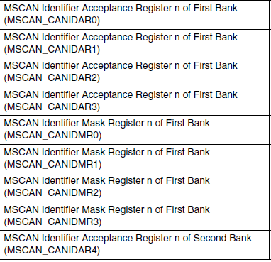

Also for the part of the ID, I am interested in just reading one specific ID. What do I need to configure to the MSCAN_CANIDAR, MSCAN_CANIDMR, MSCAN_RSIDR register to read only the id 0x7E8?

Hello Emilio,
-In the function of "CAN1_ReadFrame()" have clear  the Rx flag:
Clearly the flag of the register MSCAN_CANRFLG to have a try.
- The ID length  of 0x7E8 is lager than 11, so here only can use the Extended ID .
I refer to the Reference manual to calculate it , you can also try to calculate and check whether
is right about mine  the result is
MSCAN_CANIDAR0 = 0x00;
MSCAN_CANIDAR1 = 0x18;
MSCAN_CANIDAR2 = 0x0f;
MSCAN_CANIDARn = 0x00;
MSCAN_CANIDMRn(n=0,1,2,3,) = 0x00;
pay attention that , i assumption you use the data frame , not the remote frame, it is said
the bit of  RSRTR on the register of MSCAN_RSIDR1 is "0".
Hope is helps
Alice
