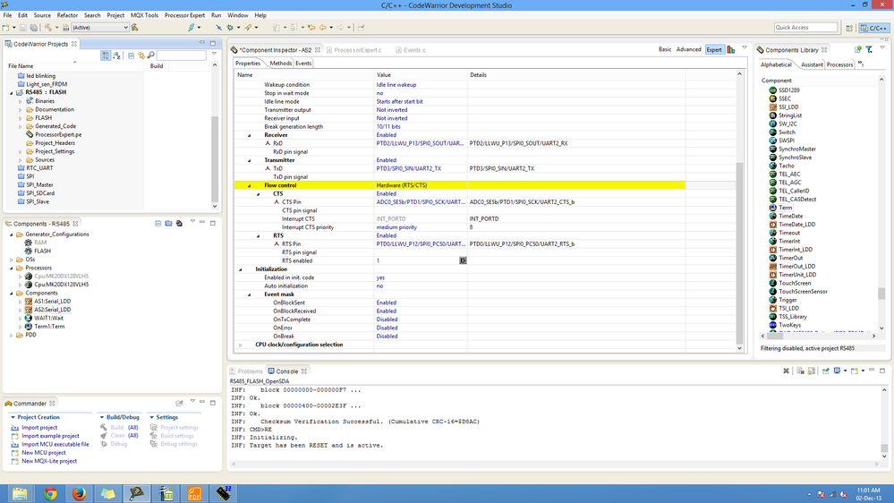

Hello
I am using UART for communication between 2uc I was wondering to use RTS and CTS as through this I can reduce the data loss but I was unable to do it so I wanted the hardware and code wise explanation for this So I wanted to know If there is any application note on this? Also I was wondering can I use these pins for RS-422 communication  using multiple uc interacting at same time ? But obviously 1 master and multiple slaves.
Thanks & Regards
Amit Kumar

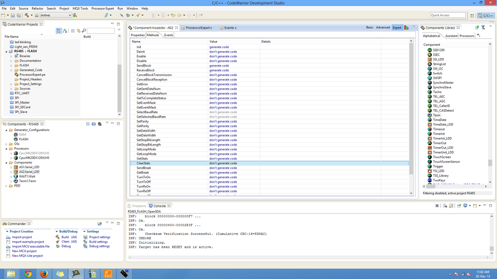

in Serial_LDD component of processor expert, I have enabled the RTS, CTS but I couldn't find its function in the method i.e when i checked in help for Serial_LDD there was functions to enable RTS and CTS but after selecting these options in the component properties, it still didn't came in methods. I wanted to know how to use these in my program.
from help ,
What is this peripheral support feature?
Thanks and Regards
