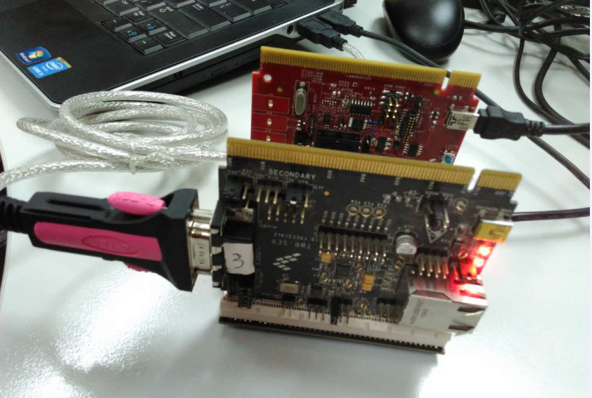

I just made a testing project with TWR-K60N512 board. printf can print to console without problem.
files under C:\Freescale\CW MCU v10.6.4\MCU\ARM_GCC_Support\UART\TWR-K60N512
are based on TWR-K60N512, please make sure you use the right board.
make sure your project is based on K60N512 chip.
Connect your host with the 9pin serial connector on the TWR-SER board, configurated for 38400 baud.
for detail, please see my testing project and video.
can this help you?

I really appreciate your help! I selected PK60N512 instead of MK60DN512Z or MK60DN512 (not sure if this actually makes any difference at all...) and also enabled OSJTAG protocol, debugged in flash mode, that seemed to have stopped my program from being suspended. I'm assuming printf() will work with the 9pin serial, which I don't have one at the moment to test, will do at the end of the day and let you know how that goes.
I'm more interested to know which UART and port to change in 'ConsoleIO.c' so that I can use the printf() function through USB instead 9pin serial, just like in the examples. Could you point me in the right direction?

if you want to use Virtual CDC USB serial port, you need revise ConsoleIO_Init() to use the correct pins.

per TWR-K60N512 schematic and user manual, you need revise ConsoleIO_Init() to use PTE9 and PTE8
please refer Erich's article for how to revise
