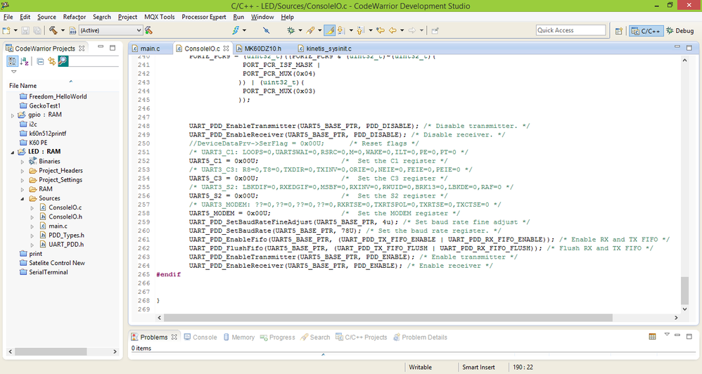

I would like to use the printf() function in a new bareboard project. I included the necessary files: (ConsoleIO.c, ConsoleIO.h, PDD_Types.h, and UART_PDD.h). My project builds successfully but when it was run in debug, it keeps getting suspended by some interrupt handler, shown in screenshot below:

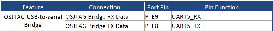

ZhangJennie
per TWR-K60N512 schematic and user manual, you need revise ConsoleIO_Init() to use PTE9 and PTE8
please refer Erich's article for how to revise

Hmmm, I followed the instructions, but my program was suspended again by the same interrupt handler when printf() is included...
Couldn't find an option to attach my source code, so here's a screenshot of it:
Hmmm, any ideas?
Quick question: what does (typecast) NOT (typecast) mean, specifically (uint32)~(uint32) at line 233?
