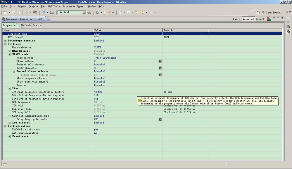

volatile bool DataReceivedFlg = FALSE;
volatile bool DataTransmittedFlg = FALSE;
uint8_t OutData[4] = {0x00U, 0x01U, 0x02U, 0x03U};
uint8_t InpData[4];
LDD_TError Error;
LDD_TDeviceData *MyI2CPtr;
int main(void)
  PE_low_level_init();
  MyI2CPtr = I2C2_Init(NULL);
  while(1)
    Error = I2C2_SlaveReceiveBlock(MyI2CPtr, &InpData, 4U);
    if(TRUE == DataReceivedFlg)
        I2C2_SendAcknowledge(MyI2CPtr, LDD_I2C_ACK_BYTE);
no ack signal
