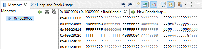

Due to bad flashing I ended with somehow locked K32L2A device. I am using mcuxpresso with mcu-link probe. New program can not be downloaded, but memory can be read, and here is protection related part ...
Device can not be unlocked / mass erased by mcuxpresso flash tool.
It is very strange to me that mcuxpresso doesn't check for operation success (or I don't know where the right checkbox is). After program is download to device there is no automatic verify, so user think that everything is OK. Same for erase or unlock because result of all this operations is OK (green / blue). Only if dedicate verify against file is executed than will be reported error (red).

nxf77486
Hello @jh0 ,
Can you please make a image memory dump in order to see the 0x400 memory section in order to discard any security.
Also please send me the command prompt of the error you are receiving in order to have more info.
4,931 Views
jh0
Hi @nxf77486
Here is 0x400 ...
If I decoded right ...
Backdoor key: 30 30 30 35 30 30 44 34
FPROT: FF FF FF FF  flash is protected
reserved FF
reserved FF
FOPT: 46  0100 0110
BIT7-6: 01 Boot reserved     BIT5: 0 Slow init    BIT4,0: 00 VLPR mode
BIT3: 0 Reset pin disabled    BIT2: 1 NMI enabled    BIT1: 1 Boot source from BIT7-6
FSEC: FE 1111 1110
BIT7-6: 11 Backdoor key access disabled
BIT5-4: 11 Mass erase enabled
BIT3-2: 11 NXP factory access granted
BIT1-0: 10 MCU security status is unsecure
