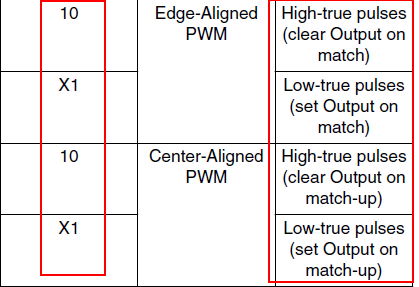

Another question: Is it possible to change the polarity of channel0?

Hello Christie,
(1) Do you want to change the frequency of PWM ? if yes , update the MOD register we can refer to the RM here :
(2) About change the polarity of channel0 ,  we can use  "ELSnB "and "ELSnA" :
( 40.3.6 Channel (n) Status And Control (FTMx_CnSC)  )
Hope it helps
