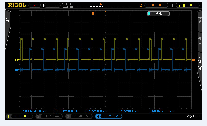

xiangjun_rong
This is the screenshot of scope. the blue is PTC1 output, the yellow is the PTC3 output signals.
XiangJun Rong

micheljssimon
Hi XiangJun Rong
From this screenshot of scopeIs is it possible to set only ch1 duty cycle from 0 to 100% maintaining the duty cycle of ch3 in 50% (ch4 is inverted in relation to ch3) and set the phase shift between ch1 and ch3 from 0 to 360°? If yes what registers should I write and what are the calculations (duty of ch1 and phase shift between ch1 and ch3)? By the way, what is the formula for writing the FTM0_MOD register for the desired PWMs frequency?
I have attached a figure to better clarify what I would like to do.
