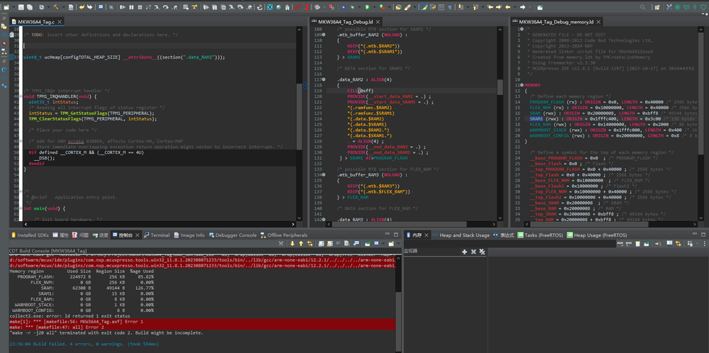

I want to define uint8_t ucHeap[configTOTAL_HEAP_SIZE] in SRAM1 of kw36.
uint8_t ucHeap[configTOTAL_HEAP_SIZE] __attribute__((section(".data_RAM2")));
Let me define this variable like this. But it's not in SRAM1.kw36.PNGkw36.PNG
Please show me how to correctly define ucHeap into SRAM1. thank you.

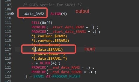

The input name is used to define the variable!!!
Like this it will work properly:
uint8_t ucHeap[configTOTAL_HEAP_SIZE] __attribute__((section(".bss.$SRAM1")));
