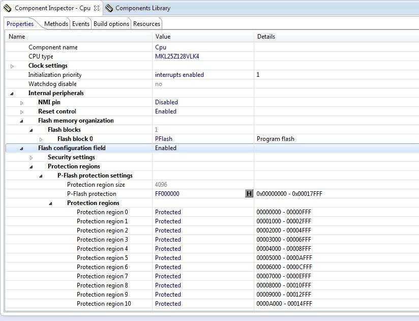

I want to flash my FRDM-KL25Z with the openSDA debugger, but after some erased sectors I got the following massage:
Erasing Sector 0x00015800 to 0x00015BFF
Erasing ...
Error:  Erase failed. Flash driver reports the following error(s):  Sector Protection Error
How cann I solve that?

I found out that the Project I work with has a protected flash area Flash protection.jpg
The unprotectet start at 0x00018000. So I startet flashing there:
So I didn't got the error, but after a reset I didn't have the new flashed code running!?
