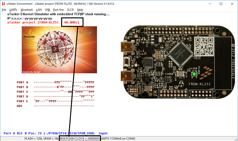

mjbcswitzerland
Specialist V
Hi Frederik
For KL25 on FRDM-KL25Z with 8MHz crystal
MCG_C2 = (MCG_C2_FREQ_RANGE | MCG_C2_GAIN_MODE | MCG_C2_EREFS | MCG_C2_LOCRE0); // select crystal oscillator and select a suitable range
MCG_C1 = (MCG_C1_CLKS_EXTERN_CLK | MCG_C1_FRDIV_VALUE);              // switch to external source (the FLL input clock is set to as close to its input range as possible, although this is not absolutely necessary if the FLL will not be used)
while ((MCG_S & MCG_S_OSCINIT) == 0) {}                              // loop until the crystal source has been selected
while ((MCG_S & MCG_S_IREFST) != 0) {}                               // loop until the FLL source is no longer the internal reference clock
while ((MCG_S & MCG_S_CLKST_MASK) != MCG_S_CLKST_EXTERN_CLK) {}      // loop until the external reference clock source is valid
MCG_C5 = ((CLOCK_DIV - 1) | MCG_C5_PLLSTEN0);                        // now move from state FEE to state PBE (or FBE) PLL remains enabled in normal stop modes
MCG_C6 = ((CLOCK_MUL - MCG_C6_VDIV0_LOWEST) | MCG_C6_PLLS);          // set the PLL multiplication factor
while ((MCG_S & MCG_S_PLLST) == 0) {}                                // loop until the PLLS clock source becomes valid
while ((MCG_S & MCG_S_LOCK) == 0) {}                                 // loop until PLL locks
SIM_CLKDIV1 = (((SYSTEM_CLOCK_DIVIDE - 1) << 28) | ((BUS_CLOCK_DIVIDE - 1) << 16)); // prepare bus clock divides (flash and bus clocks are the same)
MCG_C1 = (MCG_C1_CLKS_PLL_FLL | MCG_C1_FRDIV_1024);                  // finally move from PBE to PEE mode - switch to PLL clock
while ((MCG_S & MCG_S_CLKST_MASK) != MCG_S_CLKST_PLL) {}             // loop until the PLL clock is selected
Note that for the HW on the FRDM-KL25Z
#define MCG_C2_GAIN_MODE    0                                        // don't select high gain mode since the oscillator will not start
and not
#define MCG_C2_GAIN_MODE    MCG_C2_HGO                               // select high gain mode
and
#define MCG_C2_FREQ_RANGE   MCG_C2_RANGE_1M_8M
for 8MHz crystal
#define CLOCK_DIV            4                                       // input must be divided to 2MHz..4MHz range (/1 to /25 possible)
#define CLOCK_MUL           48                                      // the PLL multiplication factor to achieve MCGPLLCLK operating frequency of 98MHz (x24 to x55 possible) (MCGPLLCLK/2 is 48MHz - required by USB)
For the KL25
#define MCG_C6_VDIV0_LOWEST  24
All other defines should be clear from their name and reference in the user's manual.
