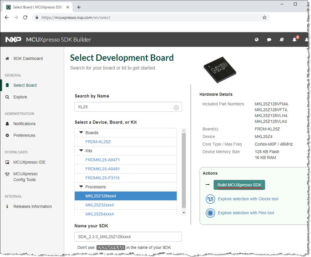

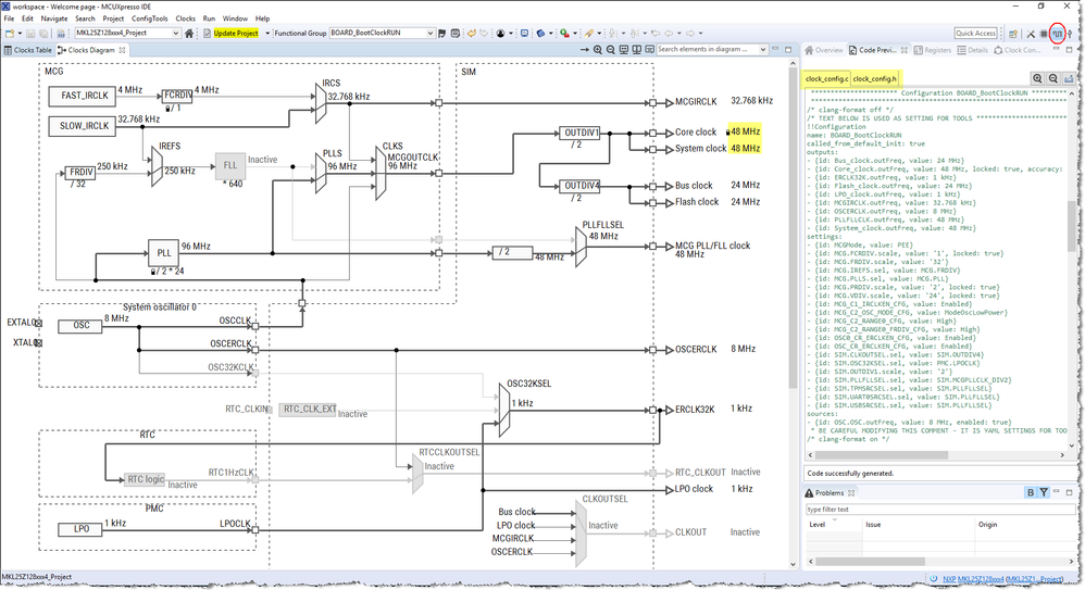

Hi Frederik,
MCUXpresso Software and Tools are recommended for customers.
The Clocks tool of MCUXpresso IDE is able to generated the these codes.
You need to download the MCUXpresso SDK for KL25 and the latest MCUXpresso IDE.
You can refer the: Quick Start Guide – Using MCUXpresso SDK with PINs&CLOCKs Config Tools
Robin

frederik_sebast
Hey Robin,
thanks again. We now switched to MCUXpresso and it works perfectly fine!
It also works on MacOs which is even better.
Frederik

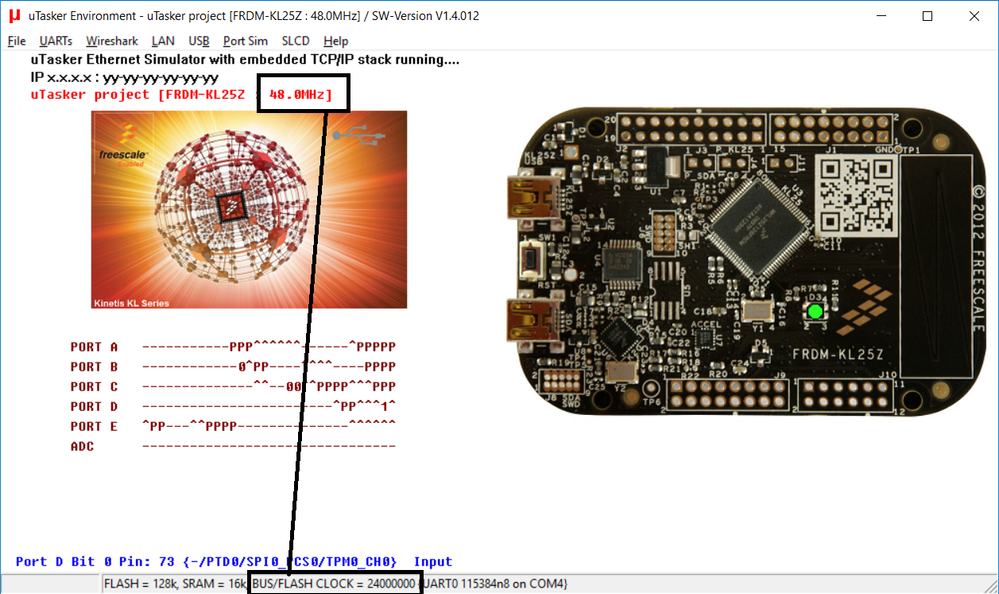

mjbcswitzerland
Specialist V
uTasker works with KDS.
User configuration for KL25:
#define OSC_LOW_GAIN_MODE   // oscillator without feedback resistor or load capacitors so use low gain mode
//#define RUN_FROM_LIRC     // clock from internal 4MHz RC clock
//#define RUN_FROM_DEFAULT_CLOCK  // run from FLL default setting
//#define RUN_FROM_EXTERNAL_CLOCK // run directly from external 8MHz clock (without PLL)
#define CRYSTAL_FREQUENCY    8000000  // 8 MHz crystal
#define CLOCK_DIV       4   // input must be divided to 2MHz..4MHz range (/1 to /25 possible)
#define CLOCK_MUL        48   // the PLL multiplication factor to achieve MCGPLLCLK operating frequency of 98MHz (x24 to x55 possible) (MCGPLLCLK/2 is 48MHz - required by USB)
#define SYSTEM_CLOCK_DIVIDE 2 // divide (1,2,3..16 possible) to get core clock of 48MHz
#define BUS_CLOCK_DIVIDE    2 // divide from core clock for bus and flash clock (1,2,3..8 possible) 24MHz
#define FLASH_CLOCK_DIVIDE  2
#define USB_CLOCK_GENERATED_INTERNALLY  // use USB clock from internal source rather than external pin
Values can be changes to suit any configuration and speed and it will tell you if anything is not legally set and generate the approx. 10 lines of code needed.
If you need a graphical tool to generate the approx. 10 lines of code you will need to use PE or MCUXpresso and copy the code into your environment.
Alternatively read the MCG chapter in the user's manual and set the registers as explained there.
Mark
