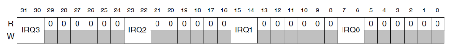

      I want set the Port B interrupt higher than RTC Alarm interrupt , Is that correct?
    ==》Set  IPR5 IRQ=4 (Lowest , RTC Alarm Interrupt)  &  IPR7 IRQ3=0. (Highest, Port B Interrupt)
                                                                                                                                                     IRQ0=4
                            IRQ3=0
Tiger

With IRQ0 as 3 instead of 4 it looks to be correct.

1. I want set the Port B interrupt higher than RTC Alarm interrupt , what the IPR 5 and IPR 7 value set ?
                                                                                                                                                     IRQ0=4
                            IRQ3=0
  2. Is the priority  IRQ0=0    higher than IRQ0=1 or 2 or 3 ?

0 is highest priority and 3 is lowest.

The values for priority that are being displayed with whichever tool is being used can't be correct. The only possibilities are (0x00 << 6) = 0x00 [decimal 0]
(0x01 << 6) = 0x40 [decimal 64]
(0x02 << 6) = 0x80 [decimal 128]
(0x03 << 6) = 0xc0 [decimal 192]
for Cortex m0+ devices (4 priority levels), whereby the Cortex m0+ only implements these 2 bits in the register so all otherwise will read '0'
I don't know the routine
void NVIC_SetPriority(IRQn_Type IRQn, uint32_t priority);
but expect that it will either want the values 0,1,2 or 3 as priority, or else will require (0, (1 << 6), (2 << 6) or (3 << 6)) depending on how it is internally implemented.
If it is not documented or obvious from examples you will need to study its code.
