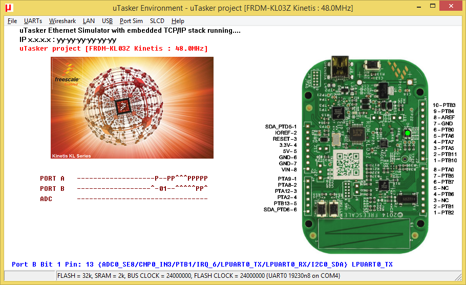

Below is the uTasker KL03 simulator confirming the clock speeds obtained:

Hi Wai Pong,
If you are using processor expert then go to CPU component and choose Internal oscillator and disable the external oscillator.
Suresh Jaggal
