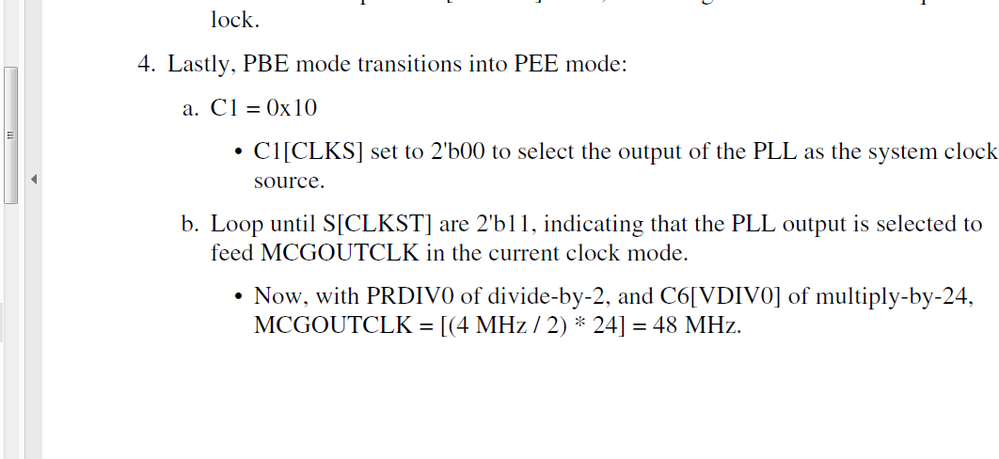

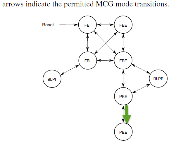

kerryzhou
Hi Thasin Akhand,
    Next time, when you post the question, please also let us know the kinetis chip part number, then we can help you to check the details.
    Yes,  when you enter VLPS in PEE mode, after exit, it will be in PBE mode.
    If you want to change to the PEE mode, you need to transfer the clock mode through this way:
Actually, in the kinetis reference manual, we have a example tell you how to change the PBE to PEE:
Wish it helps you!
Kerry

thasin_akhand
Hi Mark,
Base on Kerry comments, when entering from Run to VLPS during PEE mode, on wake up the MCG is set to PBE mode. However base on the code you provided, I have to set it to FEE to PBE and then set it to PBE to PEE. I was wondering exactly which MCG mode it is when waking up from VLPS.
6,099 Views
mjbcswitzerland
Specialist V
There may be some difference between different low power modes but the code that I use is compatible will all - it may check a status more than needed in some cases - you can also read this to get some more practical background into the principles of the modes (which are in fact just logical states based on some switches and the requirement to have the next clock source ready) - http://www.utasker.com/kinetis/MCG.html
Mark
