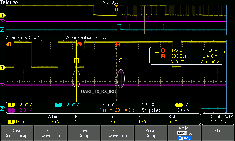

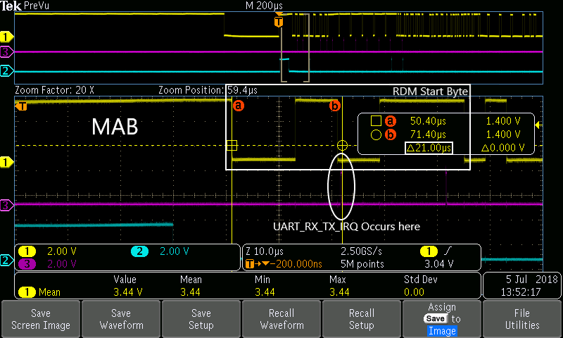

Hi just to give everyone an update. I'm running into some really weird issues with this program. After the mark after break, I'm enabling the UART IRQ and setting the interrupt to activate on the "read data register full" flag, RDRF. The UART peripheral should start shifting bytes into the register as soon as the start byte occurs which means that 44 us (11 bits) after the MAB ends/start byte begins there should a UART_TX_RX_IRQ triggered. However in my program this IRQ is triggering 20-22 us after the MAB ends/start byte. Subsequently the IRQ get triggered ~20-24 us after the previous one gets triggered. The time it takes for the IRQ to trigger after the MAB should be 44 us because that's how long it takes to shift 11 bits in. My baud rate is 250k.
I attached images of the suspicious errors. I'm debugging this program by generating a pulse on one of the pins (gpio on off) within the UART_TX_RX_IRQ handler every time it gets called and using an oscilloscope to read the pulse.

Hi Shu-Nong
This is the DMX512 Rx timing and interrupts on a K21 using the uTasker DMX512 driver (in interrupt driven mode):
1. The break is detected by a framing error interrupt 11 bits (44us) after the start of the break.
2. Subsequent interrupt occur just after the start of the start bit (or after the end of the second stop bit)
3. Following interrupt occur at each character (44us rate)
The first data byte on a DMX512 frame (with DMX content) is 0x00 - the measured delay from the end of the MAB (start bit of this byte) to the interrupt is practically about 46us.
I conclude that your possible problems could be that you
- have the wrong baud rate programmed at the receiver.
- or you have pending interrupts when you enable the rx interrupt when starting
Generally the Rx interrupt can be left enabled all the time in this mode - enabling it after MAB is risky since it is potentially time critical.
