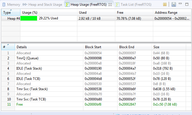

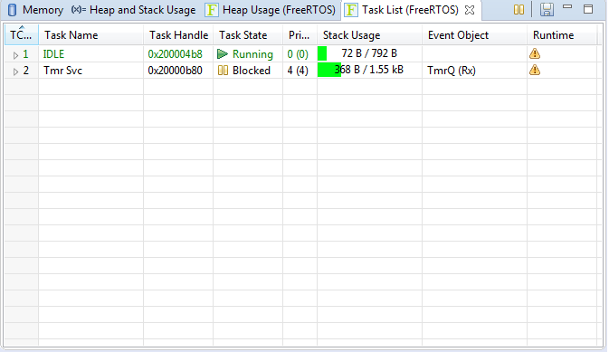

Hi Xue:
If  you are using MCUXpresso IDE, with FreeRTOS, you can see th heap and stack usage as below.
