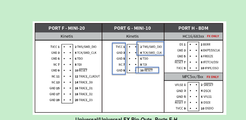

kerryzhou
Hi Gianluca,
   Your Schematic picture is really not clear, I can't check it, please give me a more clear picture.
   You must make sure the SWD wire sequence is correctly connected to the P&E multilink tool.
The following picture is from P&E multilink:
If you are using PORT G, please check the wire, is that correct to your mcu pin?
Wish it helps you!
If you still have question, please let me know!
