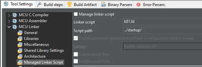

On a similar way I created my array
__attribute__ ((used,section(".FlashConf"))) const uint8_t roarray[1024*6] = {0xAE}
I proceed to create a secondary flash space. In  the MCUXpresso it looks like this on the MCU settings.
Then, I disabled managed linker script option
And I modified the linker to place my array at any desired offset on my secondary flash space.
Then the output was the following.
