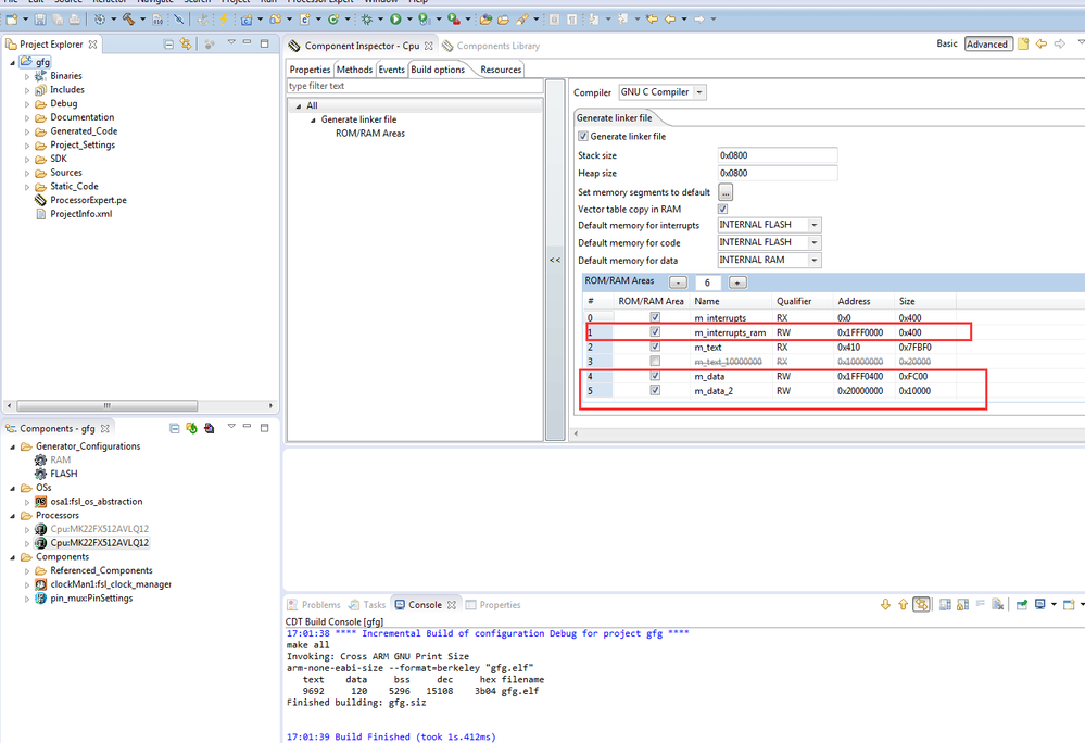

I'm hitting a stack overflow using a MK22FX512AVLQ12 device. I'm having trouble using the full amount of SRAM indicated in the datasheet.
From the datasheet for MK22FX512AVLQ12, this device should have 128kb SRAM but I'm getting linker errors when I attempt to set stack and heap to 0x0800 each:
c:/freescale/kds_v3/toolchain/bin/../lib/gcc/arm-none-eabi/4.8.4/../../../../arm-none-eabi/bin/ld.exe: [xxxx].elf section `._user_heap_stack' will not fit in region `m_data'
c:/freescale/kds_v3/toolchain/bin/../lib/gcc/arm-none-eabi/4.8.4/../../../../arm-none-eabi/bin/ld.exe: region `m_data' overflowed by 1844 bytes
Any idea why this would be? 0x0800 = 2048 = 2kb so there should be plenty of room to spare.
My linker file is attached for reference.
Update: I was able to fix the issue by disabling the "generate linker file" option and setting the start of m_data to 0x1FFF0000. I'm interested to know why PE won't let me adjust this variable in the options for the Cpu component. It gives an error: "ERROR: There is no access to memory from 0x1FFF0000 to 0x1FFF7FFF". This seems to be wrong since the program executes correctly using this configuration.

Hello Alexander,
1. Please check the Reference manual for your chip, The on-chip SRAM is split into two equally-sized logical arrays, SRAM_L and SRAM_U.
• SRAM_L = [0x2000_0000–(SRAM_size/2)] to 0x1FFF_FFFF
• SRAM_U = 0x2000_0000 to [0x2000_0000+(SRAM_size/2)-1]‍‍‍‍‍‍
So for the chip of  MK22FX512AVLQ12 :
SRAM_L =0x1FFF0000   to  0x1FFFFFFF
SRAM_U =0x20000000   to  0x2000FFFF
2. "region `m_data' overflowed by 1844 bytes" meaning in the region of 'm_data', the data overflowed
1844 bytes, not just occupied 1844 bytes.
3. You can put some data into 'm_data_20000000' region to have try.
Hope it helps

Hello Alexander,
- Sorry for my mistake of last reply . We can start from 0x1FFF0000, it isn't over boundary.
- And I made a project about your chip on KDSv3.2 , configure the stack and heap size all to 0x800. there is no error:
Please take a screenshot about your error when setting 0x800 .
Alice
