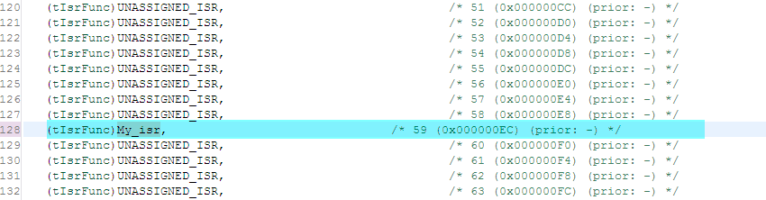

Can anyone help me with the handling interrupts in kinetis k60?
12 Replies
8,883 Views
adriansc
Are you using Processor Expert?
If not, first you need to use Enable the Interrupts:
  1. EnableInterrupts --> This enables all the core interrupts.
  2. enable_irq( irq vector - 16) --> This enables an specific irq.
After this you need to code your ISR e.g
     void My_ISR() {
      //ISR code
and put the name in the specific vector in Project_Settings-->Startup_Code-->kinetis_sysinit.c (do not forget to put the prototype as external in kinetis_sysinit.c)
In the attachments you can find the code for enable_irq().
If you need it I can post an example later,
Regards.
