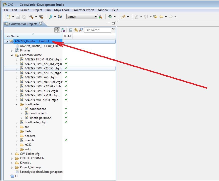

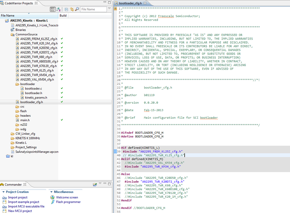

pavel_krenek
Hi Lander,
I did some print screens of setting in CodeWarrior 10.3, it would be more helpful for you:
First step choose the correct TARGET:
Second step choose correct configuration file (cfg):
I hope that helps,
Pavel

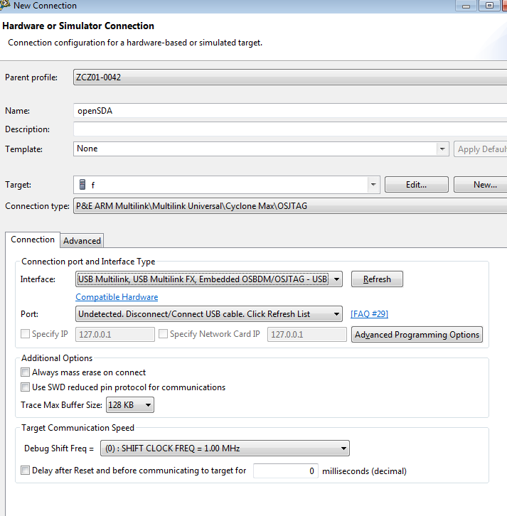

lander
If I already have OpenSDA on my KL25z, how to I also allow Multilink debugging for this project?
Thank you.
8,488 Views
pavel_krenek
you can select conection type P&E ARM.... and in Connection type you can choose Interface Multilink or OpenSDA debugger:
Pavel
