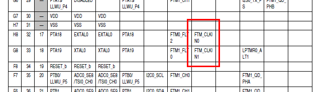

Per RM, the FTM has 3 clock sources to select:
FTM source clock is selectable
• Source clock can be the system clock, the fixed frequency clock, or an external
clock
• Fixed frequency clock is an additional clock input to allow the selection of an on
chip clock source other than the system clock
• Selecting external clock connects FTM clock to a chip level input pin therefore
allowing to synchronize the FTM counter with an off chip clock source
When you select the ext clock source, the clock is from the pin of FTM_CLKINx. Please kindly refer to the following for details.
You may find these pins are not from EXTAL32 pin. so I am afraid you can not use it in that way.
Sorry for the inconvenience that might cause.

Kan_Li
PTA18 and PTA19 are EXTAL and XTAL at default, if you use them for FTM_CLKNx function, the system OSC can not work properly as the connection between external crystal and OSC is not available , so in my opinion , you may use the EXTAL32 and XTAL32 to connect the 32,768KHz crystal , which can be used as the reference clock for MCG, and MCG can be put into FEE mode then, and on PTA 18 / 19, you may input a external clock(not crtstal) on one of them, then configure the FTM clock source from the FTM_CLKINx pin.
Hope that makes sense,
B.R
Kan
