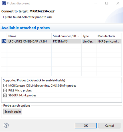

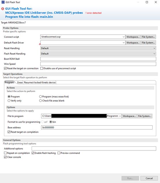

Now I connect the LCP-Link 2 with the JTAG/SWD interface J27 on the EVAL board and press the GUI icon.Nobis1_0-1631174154145.png
The following window appears:
The LPC-Link 2 is detected
When confirming the window with "OK" the following window appears:
After I have selected my compiled program (as .bin file)
The program asks me for a "Deafult Flash Driver" this is a .cfx file. When I click on "File System..." there is no cfx file for my µC.
My previous searches have also found nothing where I can get this file. I have also searched for .axf files as these are renamed .cfx files.
Can someone give me a hint or help?

Regarding the Flash Magic Firmware : Unfortunately this tool does not have support for Kinetis MCUS. It  has SWD support and USB, but not for all parts ; Its manly used for ISP programming by UART.

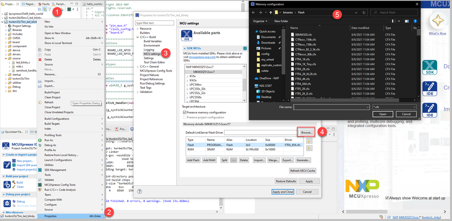

About the CFX file, which is required for the MCUXpresso to know how to program the internal flash,
one  way to find where it is ,  below:
From a previously imported SDK project, do  a left click (1) and navigate through  the next steps from  the below image.  In step (5) you will find the .cfx file for your project : FTFA_KM.cfx . Actually you will be able to see it in a  similar path  :
C:\nxp\MCUXpressoIDE_11.4.0_6237\ide\plugins\com.nxp.mcuxpresso.tools.bin.win32_11.4.0.202108051708\binaries\Flash
In a similar way, as shown in the above image ,  you can specify the KM35 .cfx driver for your project.
I am not aware  the reason why your project does not have the CFX file for the KM35 , maybe you are doing a code migration , but  I recommend you to start from a new project  and perform code migration manually, if that is the case.
Another thing, the TWR-KM35 has an on-board debugger, if you are attempting to program the board for the first time, make sure that you are setting the board jumpers correctly , to enable debug with an external target. Please refer to the board board user guide for more details.

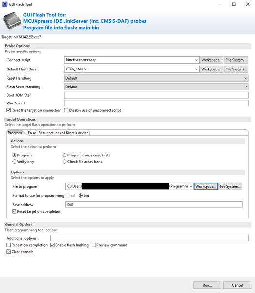

I adapted their steps and got a little further than before.
Here is a picture of the settings:
At first glance, the specifications regarding flash and RAM memory correspond to the specifications in the data sheet. The specifications concerning "UPPER SRAM" are missing.
Here is some information about the cabling of the individual devices:
the LCP-Link 2 is connected to the PC with a USB cable.
The EVAL board TWR-KM34Z75M is connected to the PC with a USB cable for power supply.
On the board of the LPC-Link 2 the "J7: JTAG/SWD for Target" interface is connected 1:1 with the J24 "KM34 JTAG / SWD CONNECTOR" of the EVAL board.

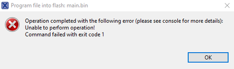

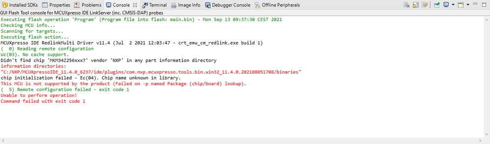

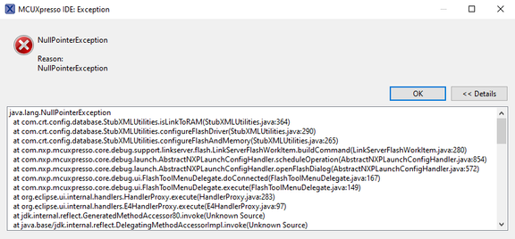

If now the "GUI Flash Tool"  Nobis1_2-1631517952798.png is pressed,  the following window appears:
When pressing "RUN" an enormous "NullPointerExeption" appears which I will not show completely.
If this window is acknowledged with "OK" the following error messages appear:
Unfortunately I do not know further and hope you can help me, that I can flash the µC.
Please for further support.

The memory settings for the KM34 are ok, as they are the ones defined in the SDK examples.
There is a migration guide from the Kinetis KM34 to the KM35 ( AN12847 ) that gives us useful migration considerations  . An example of them , is  from the  SDK  perspective,  there  several changes related to APIS , and some of them are in regards to the flash memory drivers.
If I understood well your migration process ( if did not  let me know )  the above  app note could be followed straightforward , in your case backwards to the KM34 , if your original KM35 project were made with  MCUXpresso IDE.    To migrate an IAR project to the MCUXpresso IDE, or vice versa, the less error prone way is to start  in  a fresh project and manually  add your application files.
For your current errors with the Flash GUI tool ,  it is likely that you are having problems related to the migration of your project from the IAR IDE , as I am not currently seeing an error with the configs that you showed me  . A quick test is to try to debug an SDK example project or a new project , if you are still having similar issues to debug , maybe something in the workspace went wrong ; in that  situation , an easy way to avoid the error is to start in a new workspace environment.
