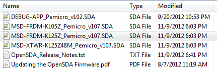

A new version of the MSD Flash Programmer OpenSDA Application is available here: http://www.pemicro.com/opensda/
This adds support for Linux.
HOWEVER, note that there isn't yet an update for your bootloader (also a mass-storage interface) to add Linux support.  So, you'll need to find a Windows machine to use the bootloader to swap out (upgrade) the OpenSDA Applications.  Sorry for this temporary inconvenience.

mnorman
I just now hit the link and downloaded the Pemicro_OpenSDA_Debug_and_MSD_Apps_2012_11_09.zip file. Inside I found:
MSD-FRDM-KL25Z_Pemicro_v107.SDA is the file you want to use.
By the way, there has been development on an application that will upgrade the OpenSDA bootloader in the field.  We've solved the Linux issue for the Bootloader as well (same issue as the MSD flash programmer). Soon you should be able to upgrade the Bootloader and not have to go back to windows to swap out the OpenSDA applications. Stay tuned and let me know how this goes for you.
-Michael
