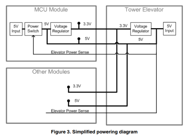

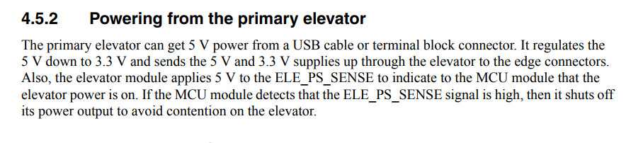

Hui_Ma
The NXP tower system power could from MCU Module or Tower Elevator:
More detailed info, please check AN4390.
The TWR-ELEV PRIMARY board schematics could get from here.
Wish it helps.

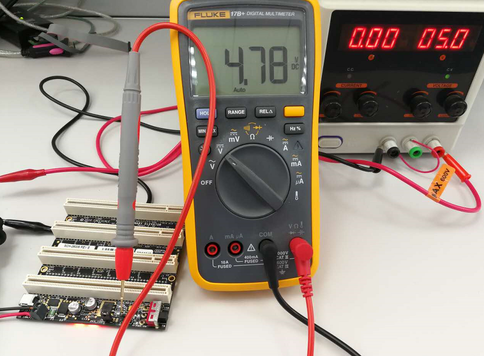

Hui_Ma
I do a test at TWR-ELEV PRIMARY board:
Test 1: 5V power from external DC power supply:
Test 2: 5V power from USB port:
Wish it helps.

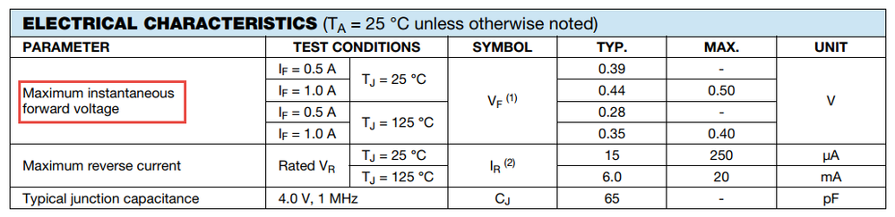

Hui_Ma
Please check my comment below(based on TWR-K64F120M board schematics):
Below is the MSS1P3L parameter:
Ma Hui
