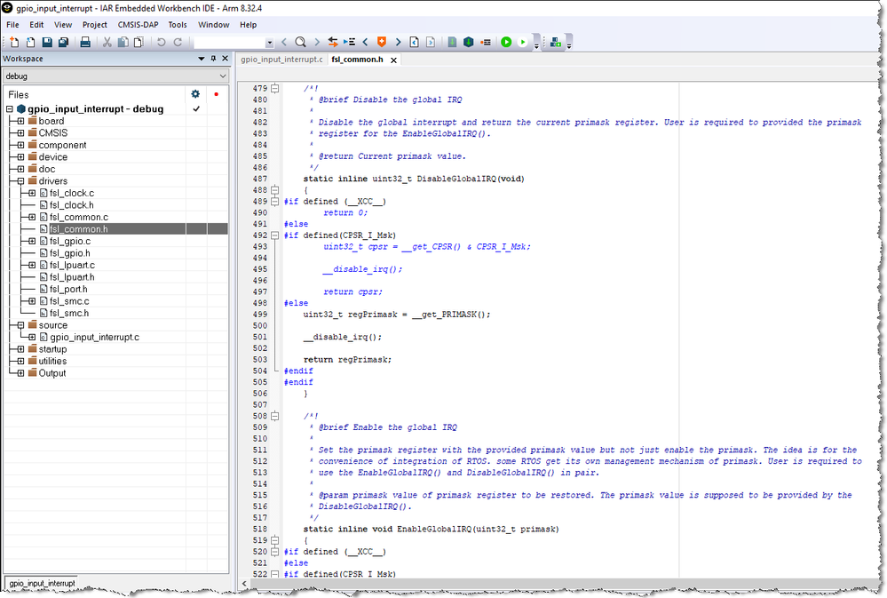

I'm using MKE15Z256VLH7. Sometimes I need to mask global interrupt, are there APIs in SDK 2.6.0 to disable MKE15Z256VLH7's  global interrupt?

Please try to use DisableGlobalIRQ

I got it. Using the DisableGlobalIRQ() function to disable in fsl_common.h file.
